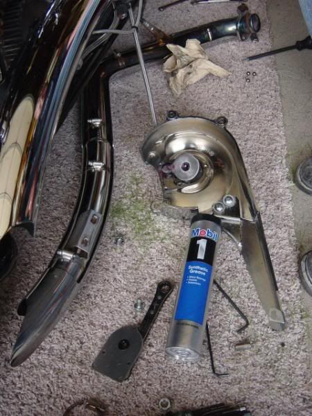

The diaphragm spring points down or the crown to the top side. The outer edge of the spring rides on the seat diaphragm spring on top of the pressure plate.

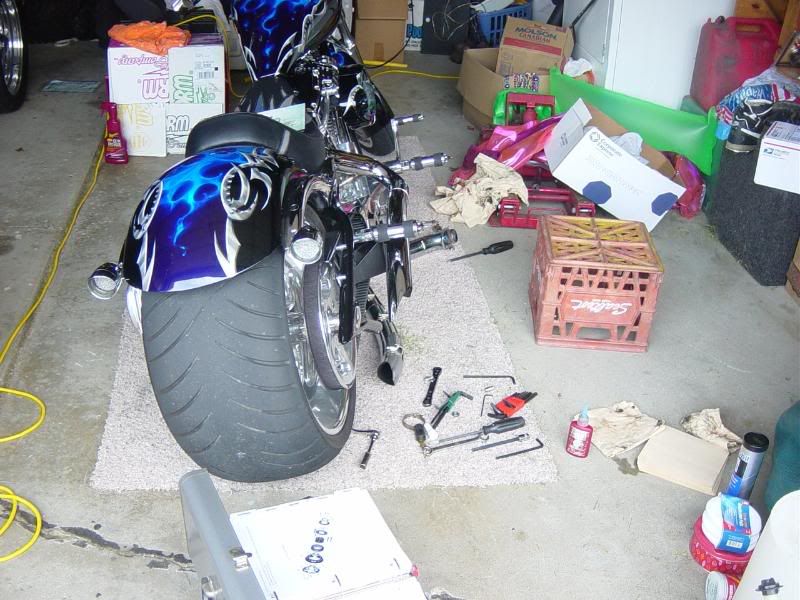

Not big on askin for help Gas kinda offered. Actually I'm not sure on this alum polishing thing you wanna come help:roll: :roll: :roll: You are welcome at my house anytime T:2thumbs:

You da man:2thumbs: After every dealership in Mi told me they could'nt even look at for a week I said piss on that and went in to see if the nut was loose and yuppers that was it. thanks guys

Sure... here's what the nut will look like
After you pull the diaphram spring off
The fix is simply tightening it to 80 ft lbs
