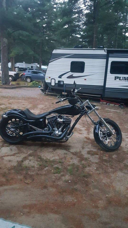

You mean the #29 bolt on the back of the carrier? You may be correct Paul, good thing you have "No mechanical experiance" at all! Ha!All the inner primary bolts are longer than the one in his picture. It came from the carrier I think.

Your welcome Mike, I think Paul may be correct thinking it's from the carrier, check out the #29 bolts in the diagram he sent ya, you may wanna see if you can feel around the back to see if one is missing.Thanks for all the help

That took a beating, some of the holes look elongated alsoWell i found the problem!![]()

Yup , mot happy ! I had,a guy do work on this bike about a year ago on the clutch. Are those bolts suppose to have Loctite on them.wow...4 missing?
I was actually only missing one but the other three was so loose when I pulled it out it just fell right outYup , mot happy ! I had,a guy do work on this bike about a year ago on the clutch. Are those bolts suppose to have Loctite on them.
