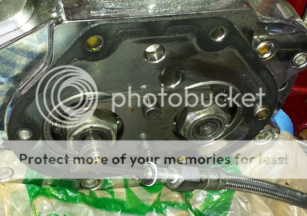

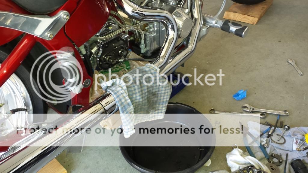

Thought it was the Clutch Cable on my 2004 Chopper. Removed cable all ok.
Checked Clutch Pack thru derby cover -- all ok.
Pulled 'clutch cable cover plate' at tranny -- OMG!
Photos show clutch "throw out" bearing blew apart and pieces all over!
Carefullly picked out every piece and metal fragment I could find.

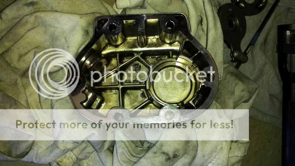

All broken parts accounted for in the 'clutch cable cover plate'

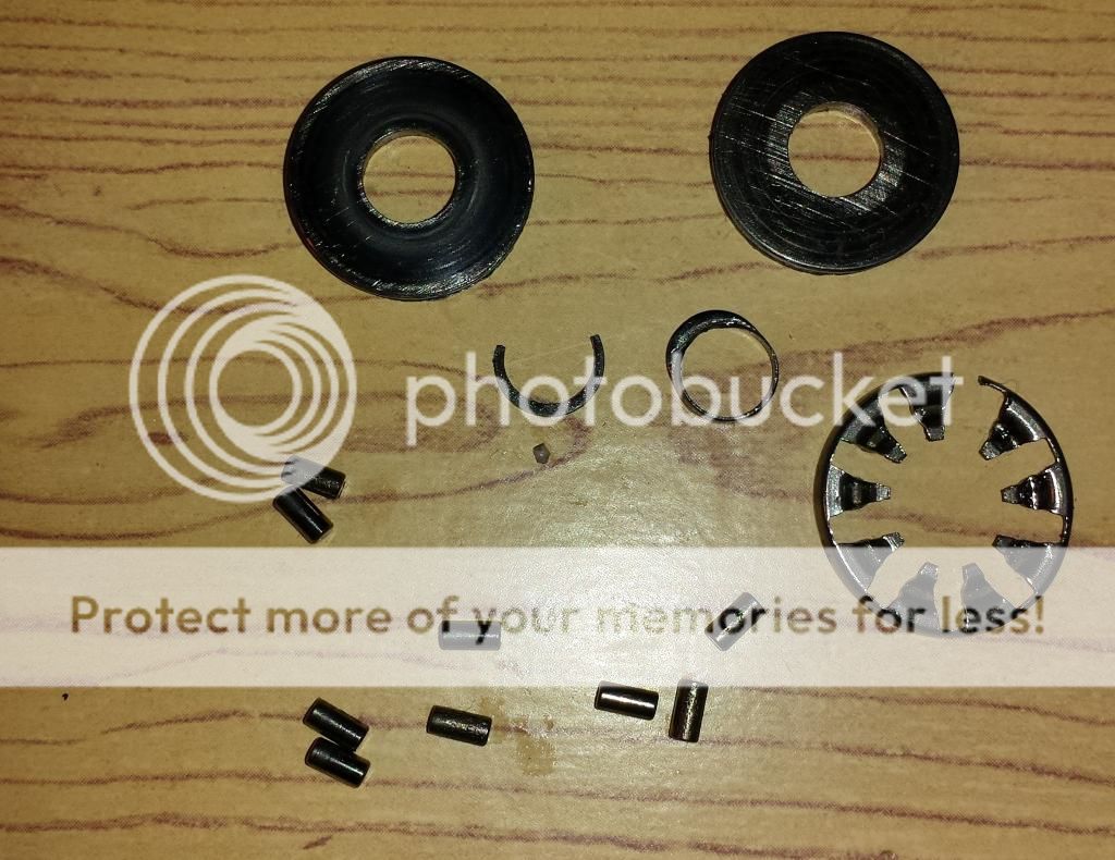

9 needle bearings, 1 clip and fragments of bearing holder, see photos.

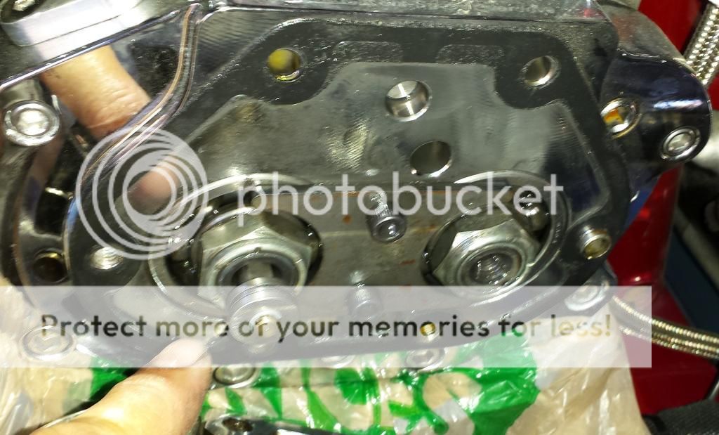

Look carefully at the left side shaft: notice near the end of the center rod it has no bearings between the two round disk spacers and the retainer clip is missing, compare to next photo.
New parts installed: 2 Spacers, bearings and holder, retainer clip.
The bad parts:

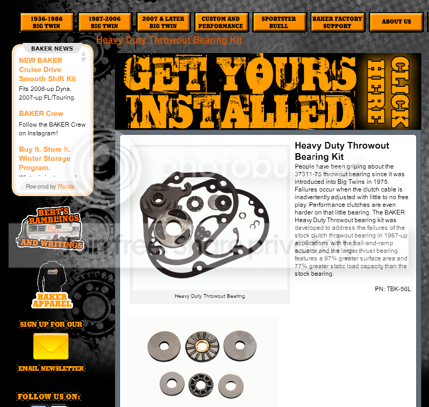

FWIW, Baker has an upgraded throwout kit for the 04's at least. Not sure about newer models. Mine took a dump and they got me the fix. No problems since.
Fat_Bastard
Hi HMAN,
We would like to hear and see more about it!
Any photos or additional vendor info?
Is it better than the stock or "Harley" version?
