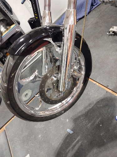

Well that's why the prices on Amazon are $25 which is much higher than the normal $15 price! I was polishing my 04 rigid front wheel this past weekend and wanted to get some more but was waiting for price to go down guess that's not happening. Finally put a steel front fender on the 04, I've had one I had bought a few years ago Shannon got it painted up for me and bam! Looks better than the fibreglass one, requires different brackets because the fibreglass fenders are wider than the steel.

I'm interested to know which polish or atom you used to clean it, it is looking such an amazing o_O
The secret is not so much in what polish you use, but how you use it. Depending on how bad your aluminum is, sometimes you may have to use courser polish first, then a fine cream.
Apply the polish with rubber gloves, not a rag. Let the polish do the work. Take your time and rub her gently, getting into all the little corners. Wipe off the excess polish with a cotton t- shirt. Then polish it to a luster, with flannel or a really soft cotton cloth. Do not use micro fiber rags, they will scratch.

I got your point, thank you so much for guiding me in details :cheers: I'll use luster polish now :yesnod:
