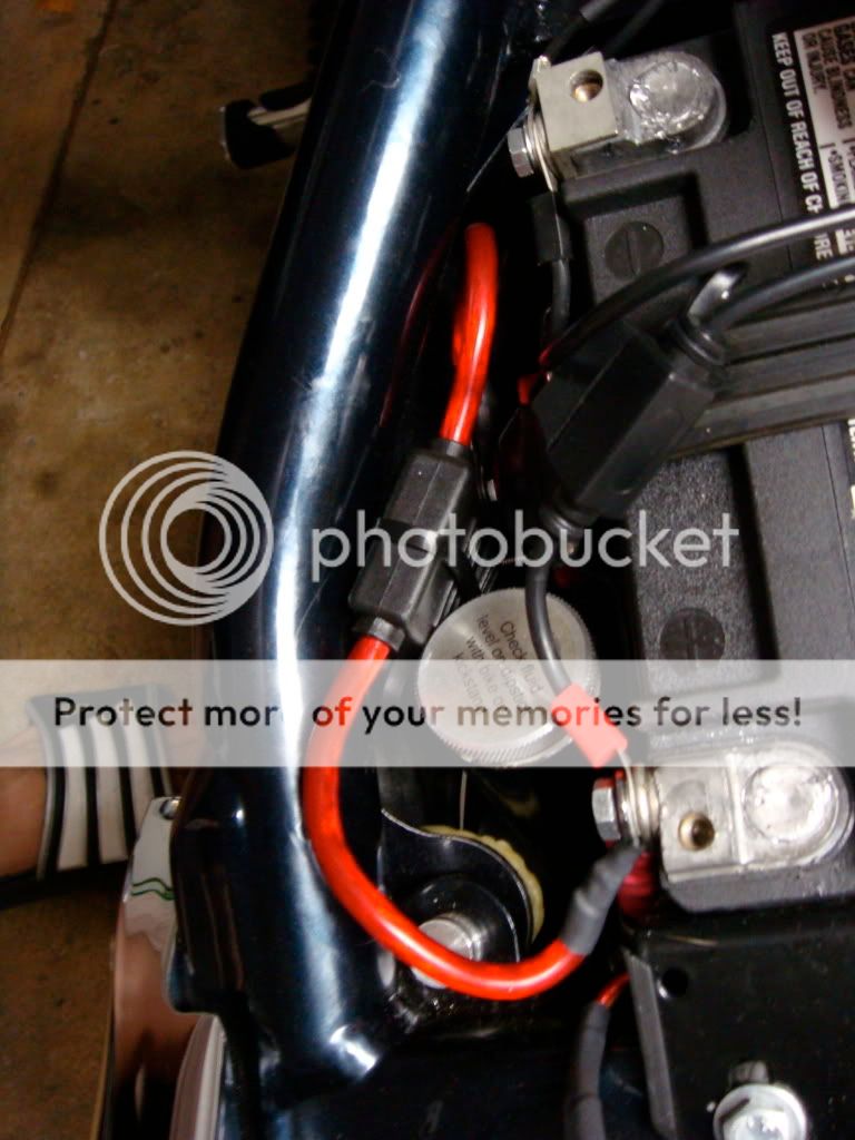

How?
So how do you guys open the oil fill cap. I have not really got into it but i did grab it and pull up on it and nothing. Tried to turn nothing. Looks like previous owner had some channel locks on it at 1 point... Should it be that hard to take off? 06 mastiff. T-Mack :job:
Daddycool
It turns counter-clockwise to loosen and yes they seem to tighten up a bit over time. Tighten it snug-by-hand when you are done.

YOU CAN PUT A TINY TOUCH OF ANTI-SIEZE COMPOUND ON THE THREADS AND THAT WILL KEEP IT FROM FREEZING UP ON YOU.

BTW, my cap doesn't screw off - it is a plug. It took a few minutes of screwing to figure that out.:loony:
