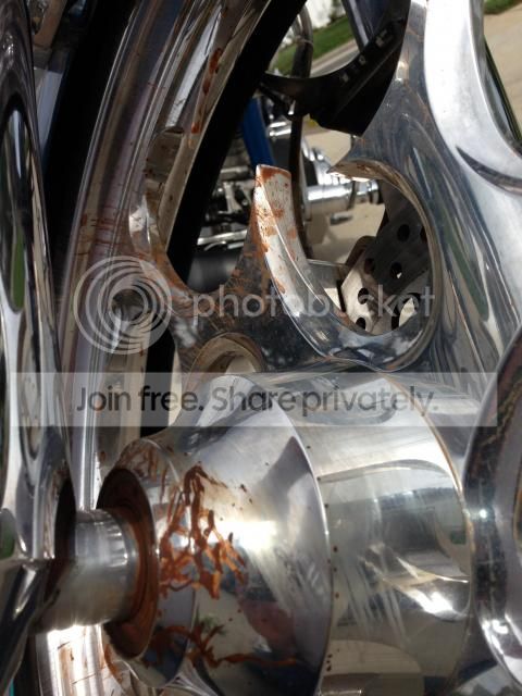

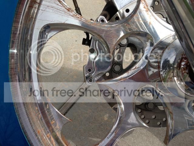

Wipe vinegar on the rim to clean the rust. See how that pans out? Yes, bearing is shot and better pull the axle now before it will rust in the center collar and you'll be hammering out the axle, bearing and collar altogether as one. Then grease the axle so the center collar is lubed so as not to happen down the road, i.e., lube @ every tire change.
