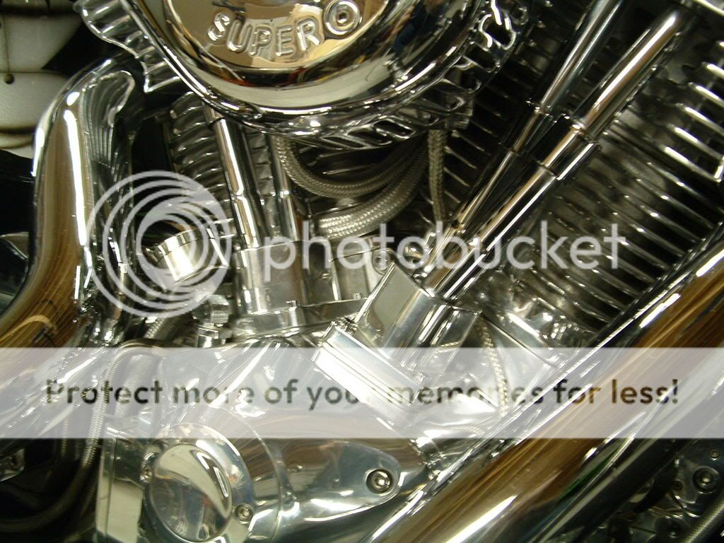

Yeah Rottie....run that shit to the ground! I have my check valve at the bottom of my bike...just make sure the white part is facing the motor....riding all summer and have not had a problem with blow by:up:

the only cover(sleeve) that I have is the carb drain hose....thats just braided sleeved over the 1/8 line.....the rear breather hose goes into the rear head...down between the jugs....down behind the pushrods...to the ground with the check valve at the end...as you can see in the pic....the front one just goes on the front head to the intake.....they just pull out....
Little-Boo
Rottie, that little round thing (Black & white) is not a breather, it's a check valve that goes between the hose that runs from the rear head to the breather. What some of us have done is taken that hose and changed it out to a longer hose (breaded looks better) and routed the new hose to an area under the Bike. Like Chopper Dave said make sure the white part of the Check Valve is installed towards the engine side or the Black part should be at the end of the hose as shown on Chopper Dave's Picture.
