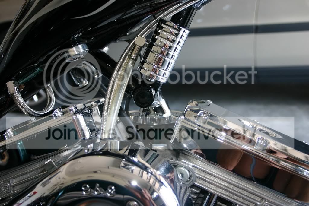

Here's a photo of the puke can I put on my '03 Chopper.
Works great and easy to maintain. It's the Wimmer.
LamboV12
Cobra - that's a great idea! With it being up, less likely to fill up.
How did you mount it - zip tie?
