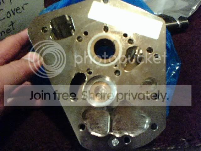

i know the JIM's cover comes with the bushing drilled and peened. on my S&S cover the bushings are just sitting in the recess. pretty sure there is a tolerance measurement on both bushings in the ssw+ manual.
