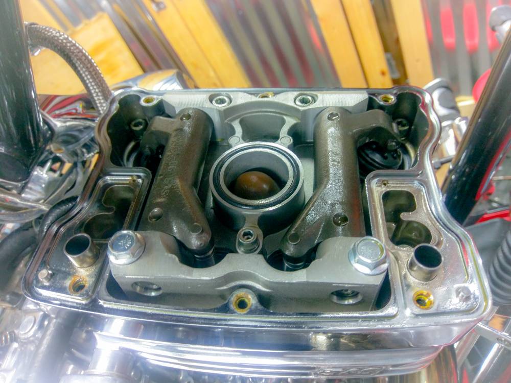

Those valve spring retainers with the holes in them are an accident waiting to happen. Major expense when 1 breaks.
John
Fantastic! Just gave me another project, like I needed one..haha. Do they even make them anymore with the holes?
What do you recommend to use to replace them? Does S&S even sell them without the springs? The springs are the Red ones if that matters.
john sachs
S&S offers valve spring kits with solid retainers. Probably costly. I offer .600" lift spring kits with Titanium or chromoly retainers. The chromoly spring kit would be perfect for your use, and will handle cams with .600" lift.
Pm me for price if interested.
