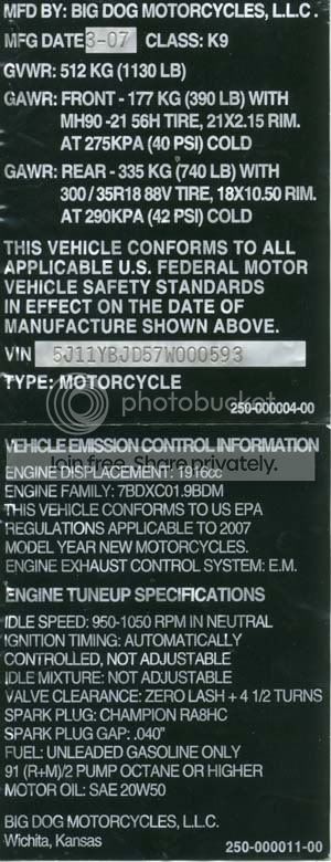

P8RIOT
Yup - here's mine - if you remove it, you really should save it somewhere:
