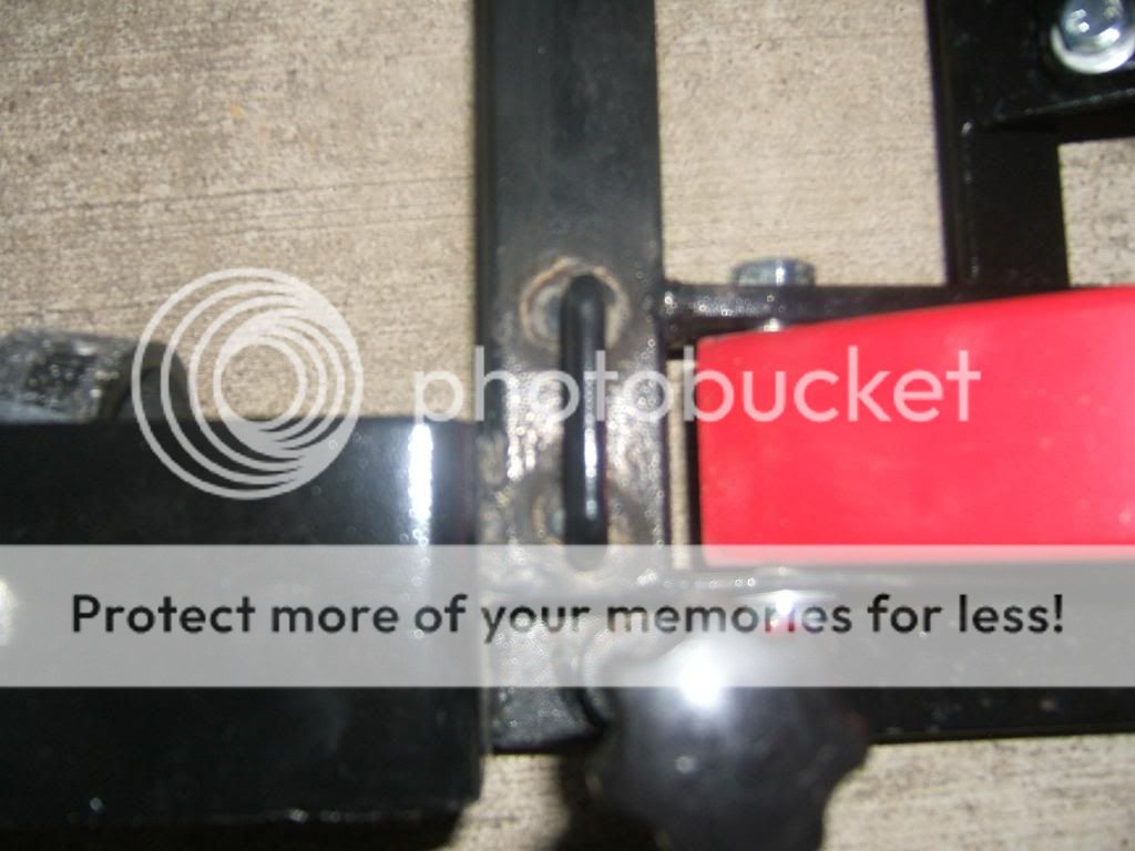

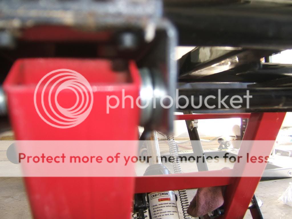

I am posting this as an FYI more than a how to so that some who may be considering a garage type jack over an actual lift may gain from my experience with this type of motorcycle jack. A mere $100.00 buys you one of these all steel motorcycle\atv jacks at the local sears store. The aluminum version is more expensive and lighter but they share basically all the same features. The fit and finish as you would expect from a "MADE IN CHINA" product is severely lacking to non existant. The first thing I noticed was that the jack would not lower all the way down far enough to get under my bike. The outer saddle edges hit the front wheels. I pulled all the bolts and washers out of the lift saddles (flat top w\rubber pads) and matched up washers to put in the inboard side of the saddles to make sure that the saddles were pushed as far to the inside or middle of the jack as possible. See pic #1 and #2 (sorry about pic quality, but you can still get the idea)

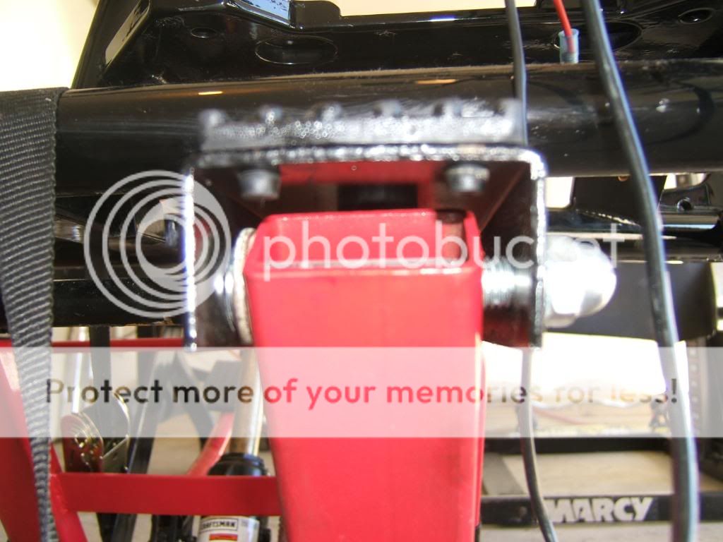

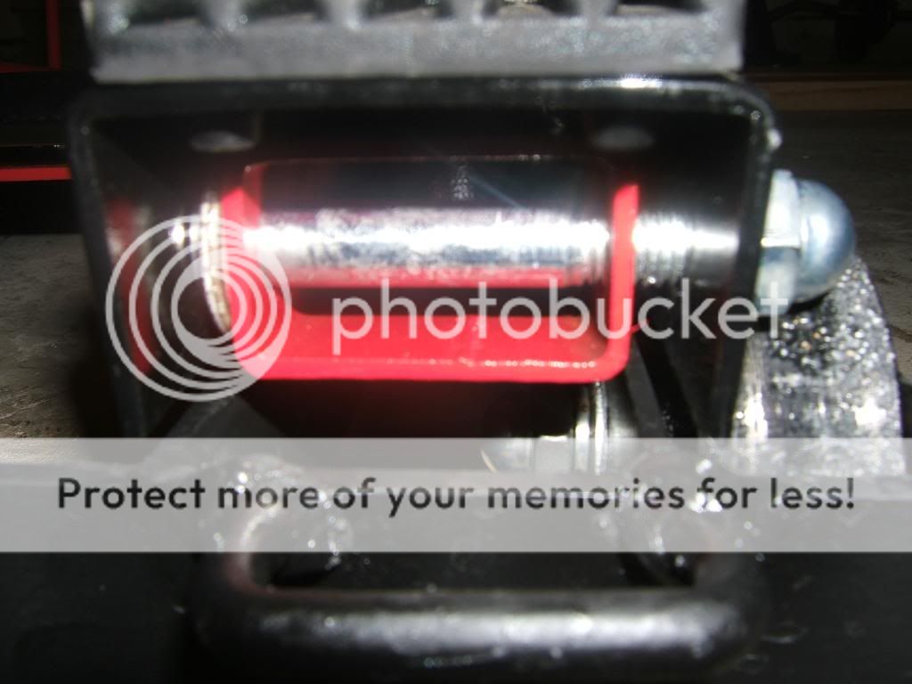

Notice how the poition of the washers holds the saddles in toward the middle away from the wheels. I did the same with washers on the wheels and pushed the wheels out as far as possible without binding them up against the wheel openings. See pics #3 and #4

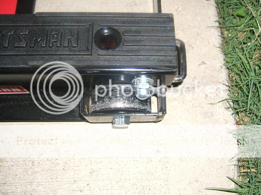

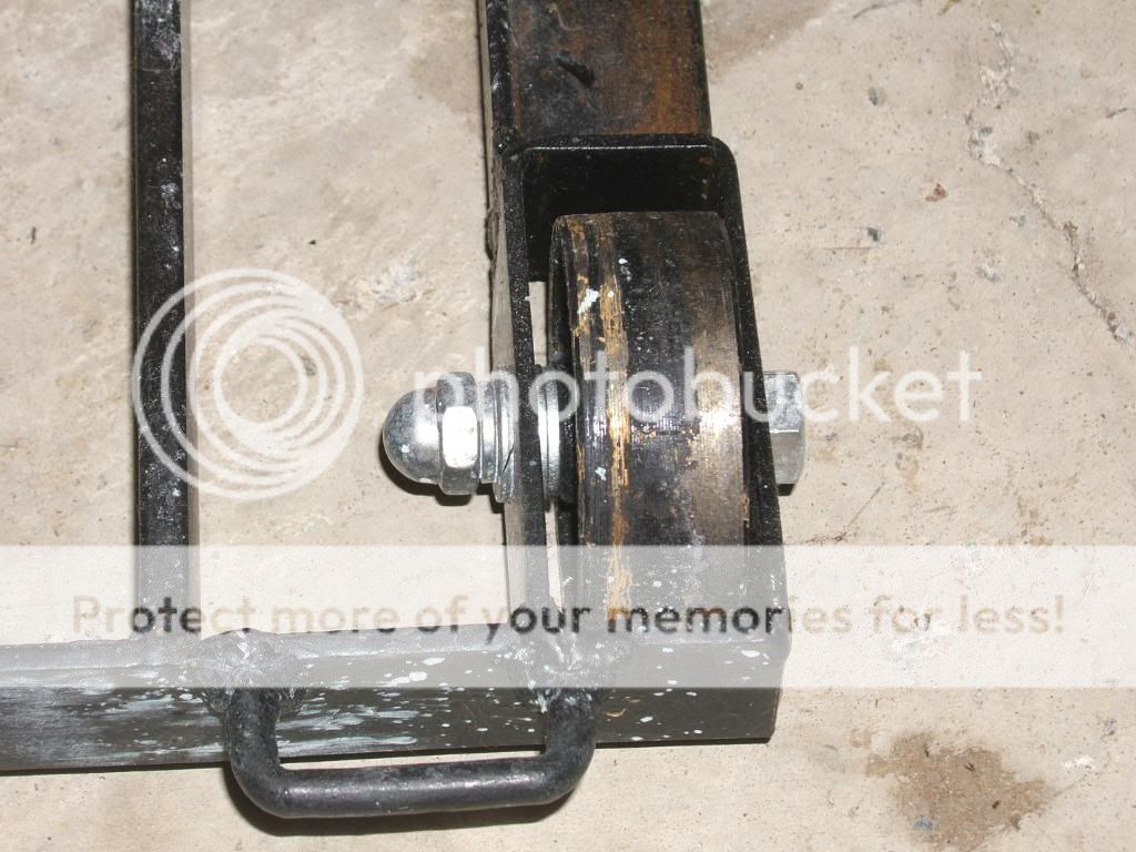

After I made the adjustments to the wheels and saddles I noticed the hoops for the ratchet tie downs on the front of the jack were angled back a bit and the saddles were hitting the front hoops when it was lowered all the way down. From the factory the front and rear hoops are welded in the vertical position. I tried to tap the hoop forward very lightly and it broke right off the front of the jack. I proceeded to break the other front hoop off also and tack weld them back on in their present horizontal position on the front of the jack. I left the rear hoops in their original vertical position, but all 8 attachment points on all of the hoops got a reweld all the way around with my mig welder. See pics #5 #6 and #7 (Note pics #3 and #4 above also show the rewelded front hoop in horizontal position)
Pic above shows rewelded rear vertical hoop
