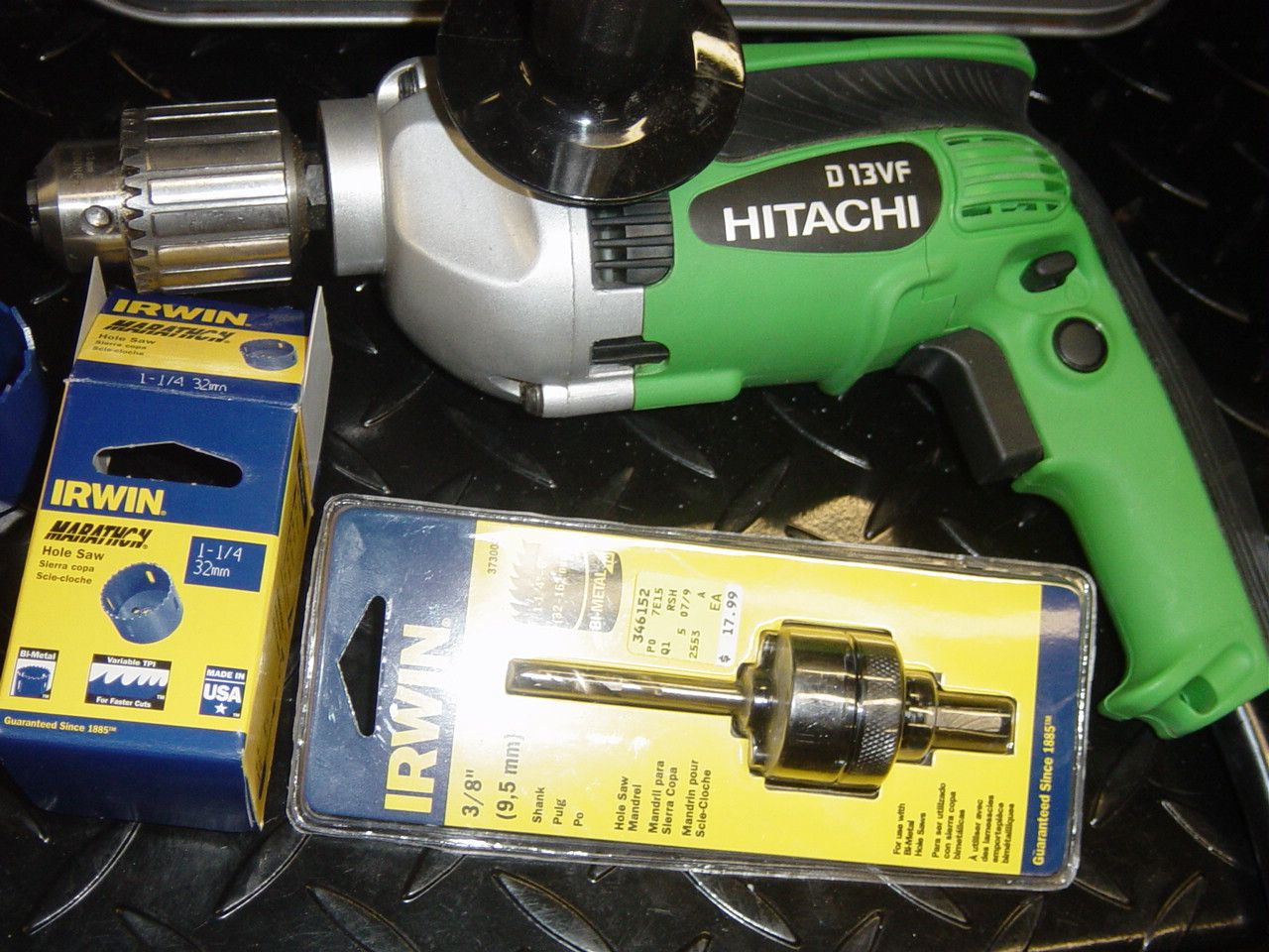

Worked on drilling out the heat shields. Picked up a real nice irwin bi metal hole saw chuck & 1.25" hole saw and busted out the big boy drill.

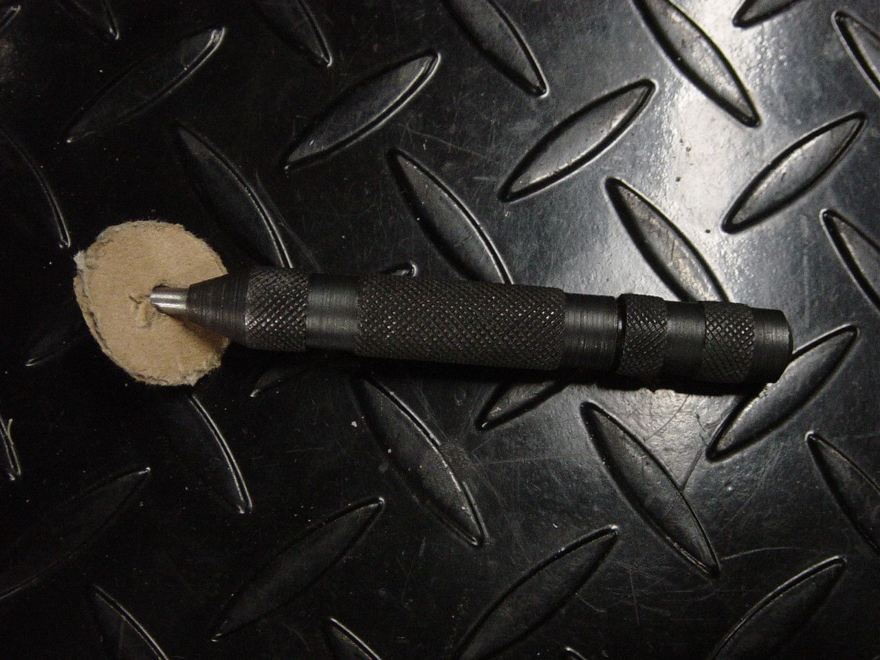

Drilled out a piece of cardboard to help with using the center punch

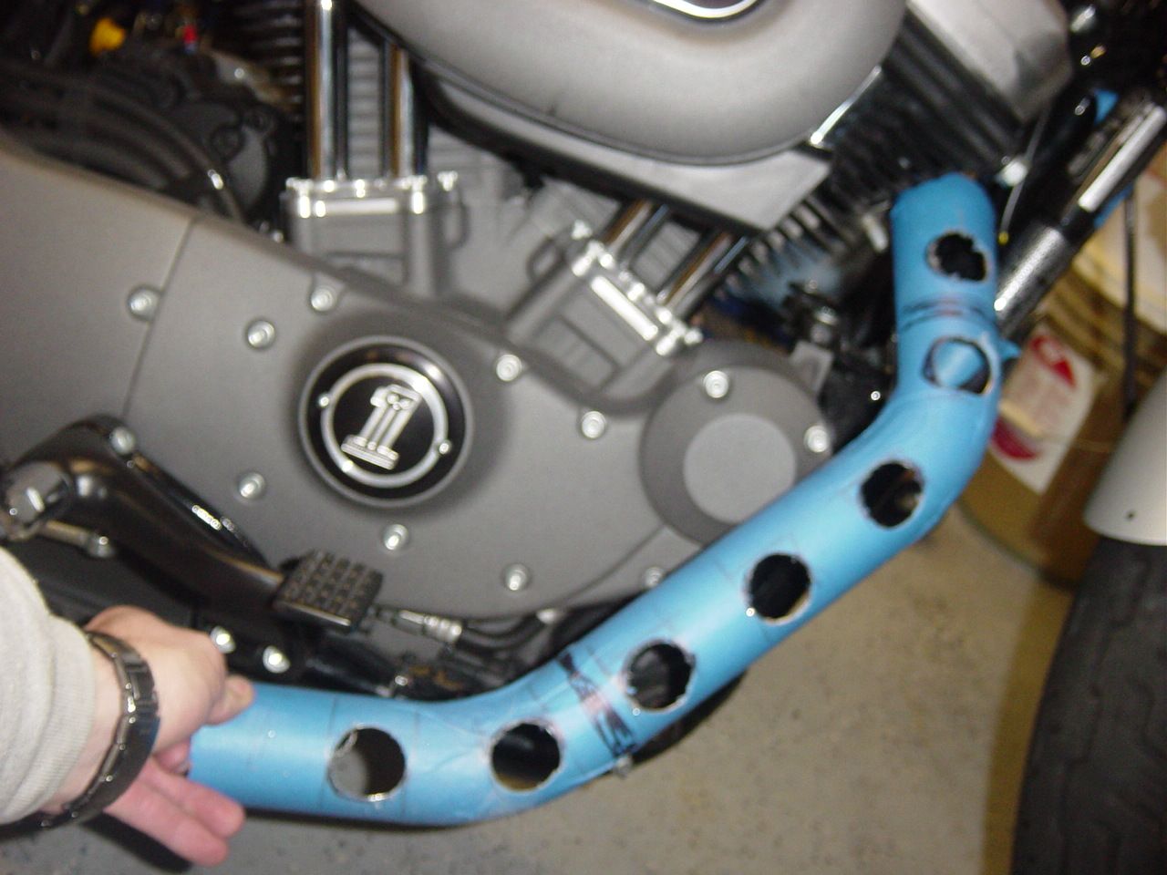

The heat shield jig or backing plate

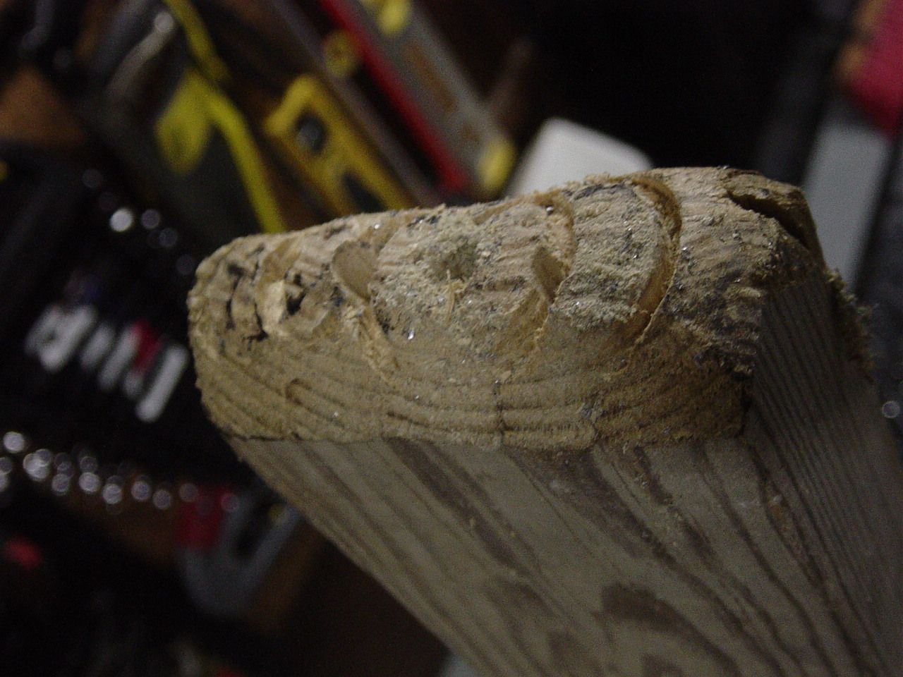

Took a few tries to get the right technique and the drill bits paid the price.
Got the first one done

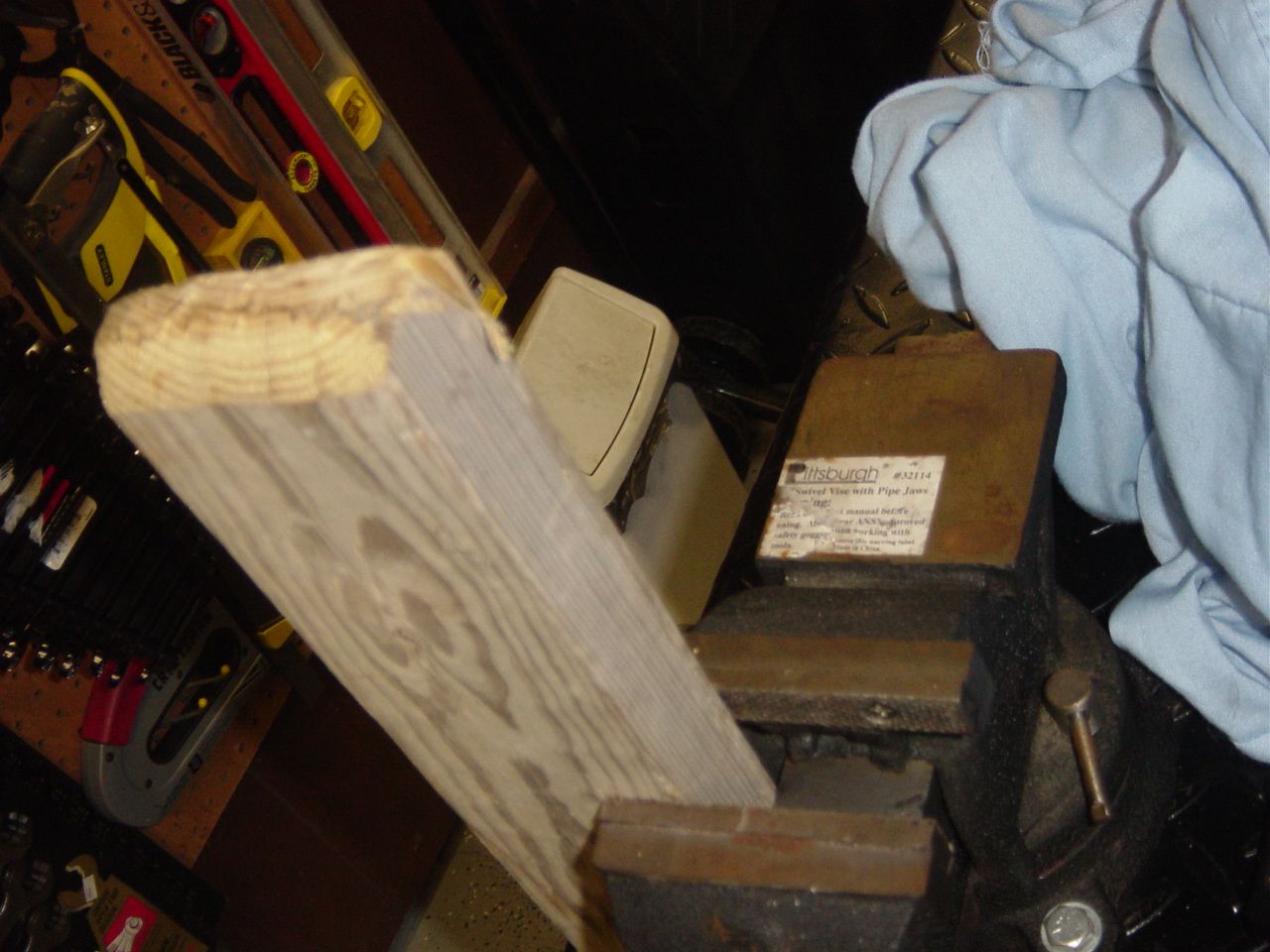

the 2x4 is working well

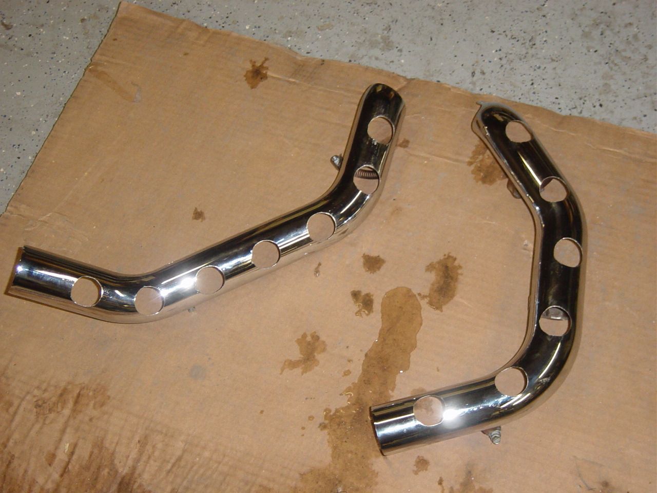

Did the 2nd one and cleaned up the metal burrs with a flat & rat tail file. All ready for powder.
I can't wait!!!
