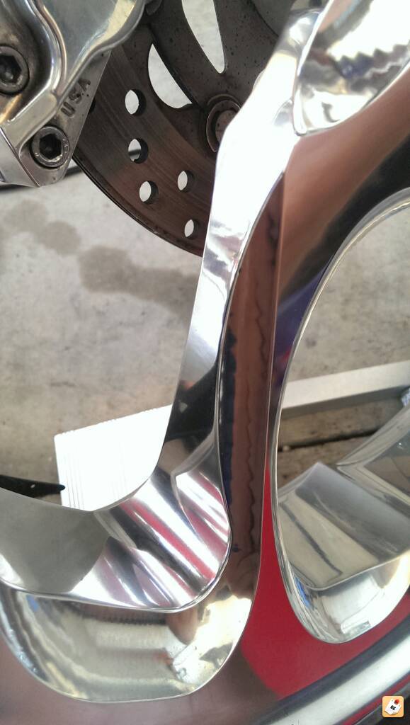

This is what I started with...
I had to use some 3M 3000 grit sandpaper I also found at AutoZone or Advanced Auto, great stuff, it's like a sponge with some super fine grit, almost like a really aggressive magic eraser. Then I used the Blue Magic cream and the rags.
Much better!
I used the spray cleaner to clean up everything else. It works great, cleaning with no streaking. It won't polish, but it will do a great job of cleaning. My forward controls were pretty grimy, just spray it on, let it sit for a minute, then wipe it clean. Just wanted to pass it on....

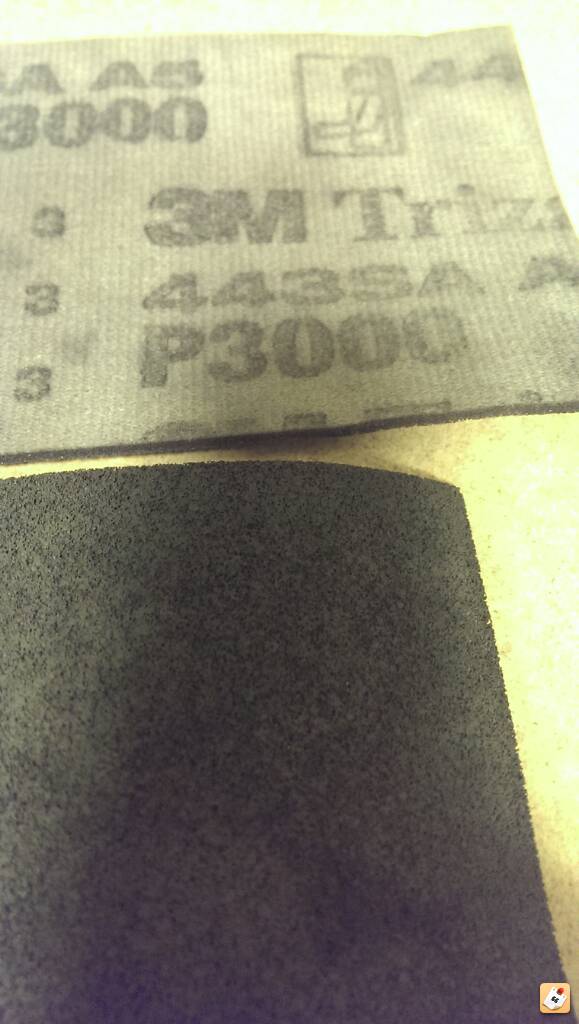

I will take a pic of the sandpaper later, it's good stuff. Really cleans up oxidation and some light scratches without leaving a lot of work to get it shiny again. In fact just one or two applications of the cream polish was enough to get it shiny again.

:eek::eek: Looks Awesome. And, Good work. I would be interested in a before and after picture when you're done. :2thumbs:
aspen874
Looks great, thanks for the tip on the 3M product, but now you have to clean that rotor. LOL
Dan22644
Thanks for all the compliments!
I will take more pics when I do the rear wheel, it's in even worse shape....
I wish I could, the rotor is chrome and it's peeling badly :(
Here is a front and back of the sandpaper, perfect stuff for cleaning up the really bad spots before polishing. As you can see it's really thick like a sponge...

So when using the sand sponge your just buffing with it first...then aplying the polish.....always afraid to try sandpaper
