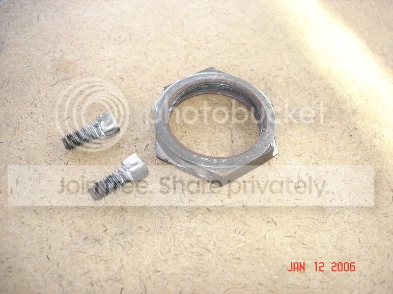

Thats happened to me and I have a thread on it somewhere here. Had to replace the nut and the hex bolts. Otherwise no other damage. I noticed the rubbing sound backing out of the driveway.
