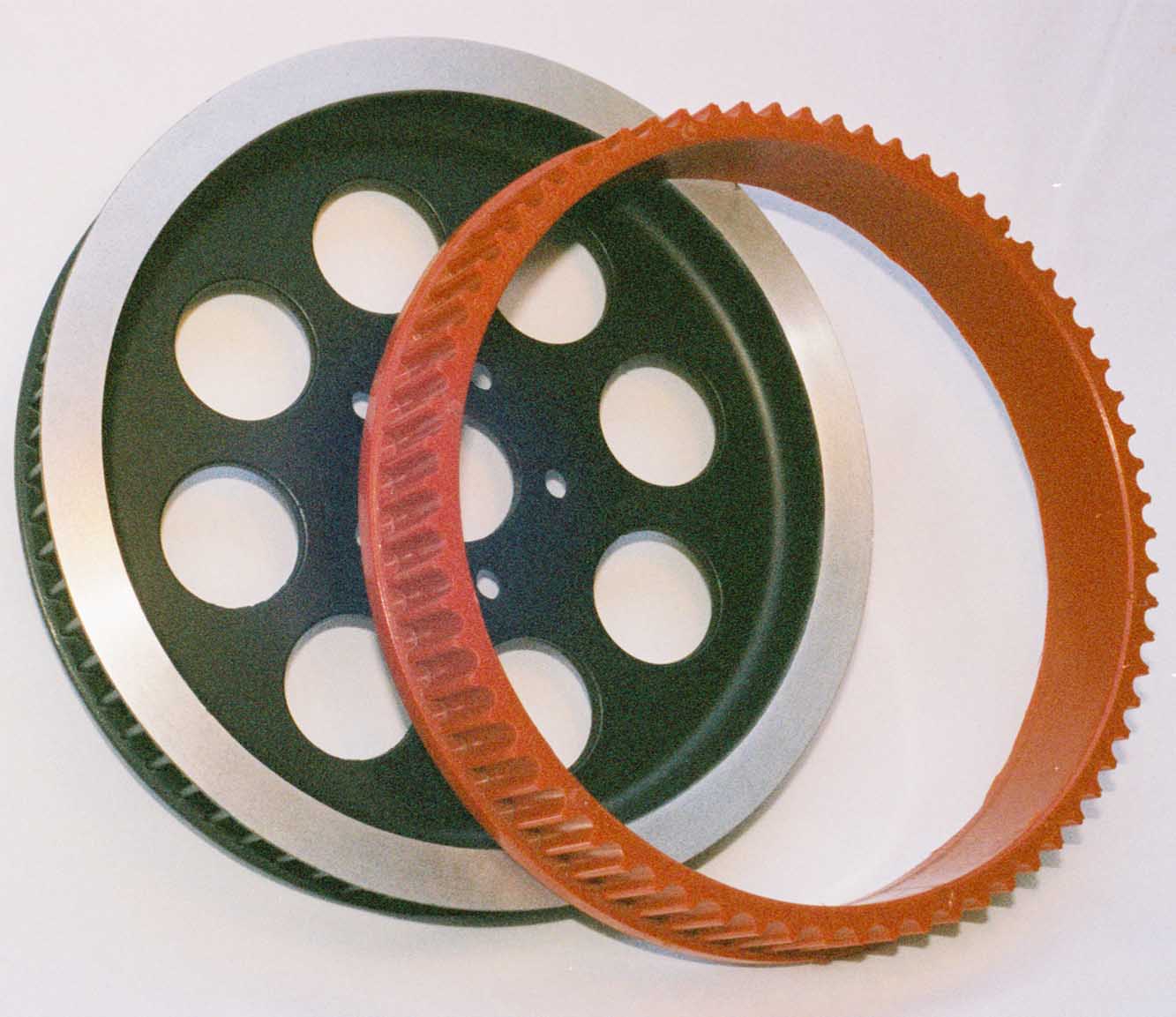

It always was worse if I got caught in the rain, or had two riders, or luggage. And yes it would get loud, Very embarrassing and very pissed off.
I put the new one on two days before S&S 50th.
Well on my way to S&S 50th got caught in a rain storm, had my girl with, and all the luggage I could fit. NOT A SINGLE TINY SQUEAK
I am so happy about it- finally.
sounds like all the bdm pulleys are coming teflon coated. The bdm rep at the show said they had a problem with 04's being cast wrong, something with the pitch or something.
I've got over 500 miles on and still quiet so hopefully alls well now. Haven't heard of anyone complaining about teflon ones yet.Just make sure alignment and tension are correct (got tensioner from Nelson) and torque pulley to 60 ft lb with RED loctite.:flag:
I got the pulley from Nelson also.
