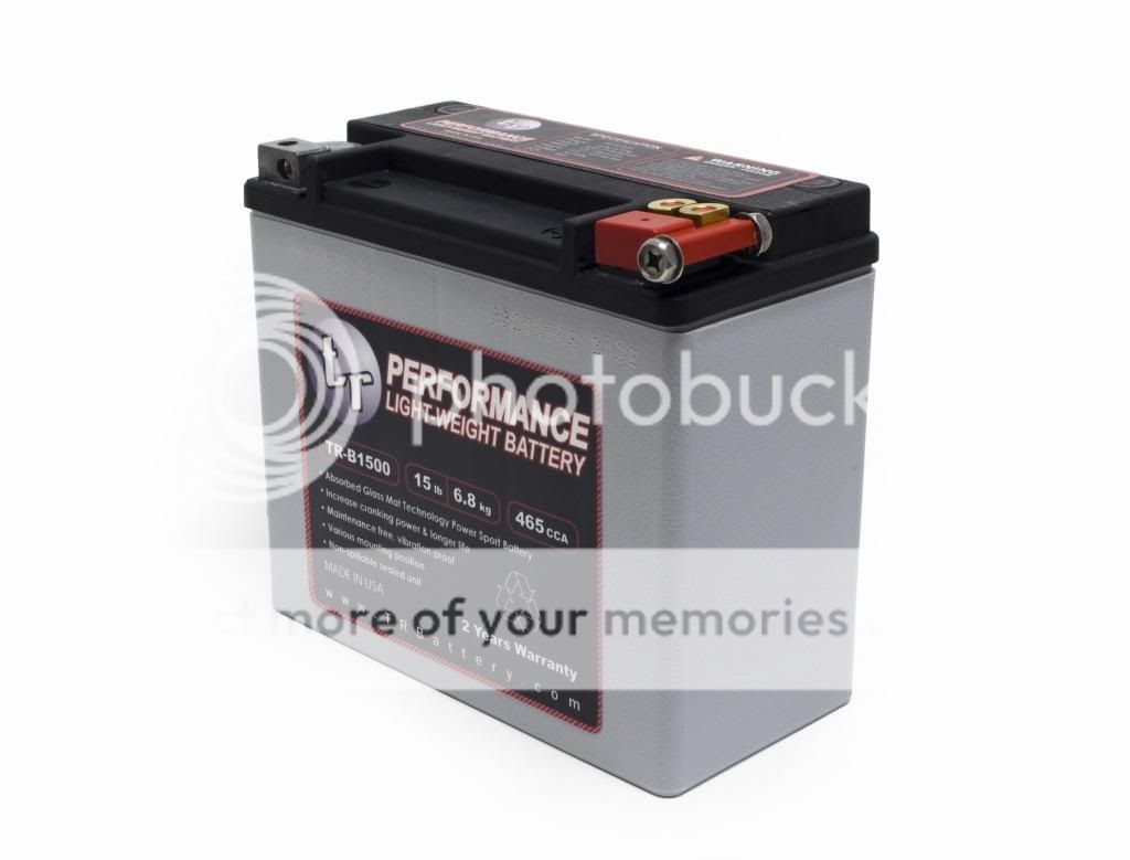

Well I picked up my 2003 Pittbull today , started up fine at the sellers house but did notice the battery was a little slugish after we rode up the block and shut her down prior loading the trailer. Well sure enough after a 2.5 hour trailer ride home there wasn't enough juice to get it started again. The thing has been sitting since 2009 so I expected a new battery and no big deal.
So what does everyone reccomend the bike has a tender already and I would like a hefty battery maintance free that will last a couple years.
Thanks Everyone

Tomioka there's a little more CCA and its what I ran on my 03 pitbull it replaced my Braille

Wood is correcto! Also if the bike doesn't already have them you may want to invest in compression releases. I to have an 03 bike. I've always had great luck with Harley agm soft tail Style batteries. They have lasted between 3 and five years on this bike.
