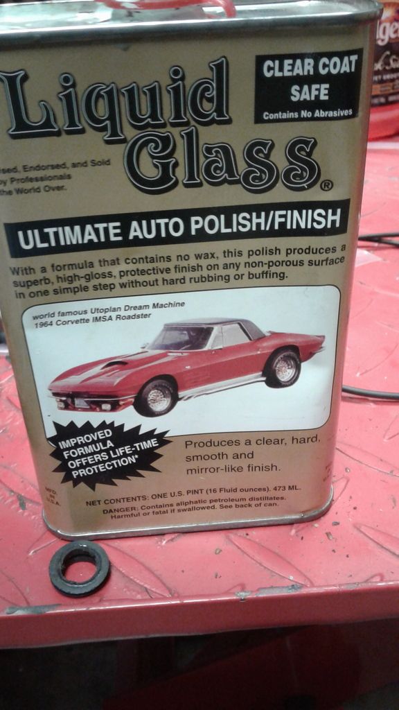

There is a product that I use, called liquid glass. I take a picture of it tomorrow, and tell you more about it. It's to late now, and I've had to much to drink to think clearly on this.

I didn't want to text drunk last night ,so I'll try it with a hang over this morning.
Like you, I was looking for a product that would seal the aluminum and keep it from oxidizing. I ran across this product and gave it a shot.
I have not used it on paint, so I can't tell you what that looks like. All I used it on was my aluminum and brass parts. Basically I tried it and forgot I used it.
After I polished out the parts, I used lacquer thinner to clean the polish off an applied this stuff. It has been two years since I used it, and I'm in the middle of polishing everything again, because I just repainted. The only way I remembered I had used it, was when I started buffing and it was making a mess. Lacquer thinner, cleaned it off really easy, and I could polish then.
This picture won't do it much justice, because my bike was really dirty when I torn down. Top was just polished, and the bottom is two years of abuse.
All in all, I'll give this product a :old2: and I'm using it again.
