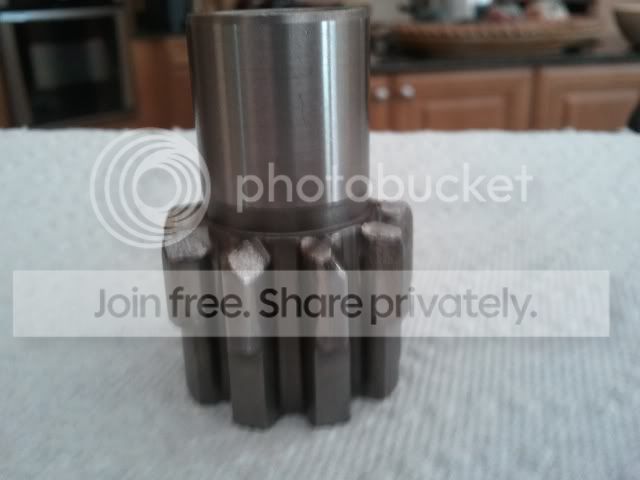

I know this is an old post,but,I'm still trying to figure out what's going on with my starter on my 02,I posted a picture under my "Bendix" thread,at the time I did not know what it was called,In my pic,the pinion gear has like 45deg.wear on each tooth.While searching I found this thread which pumpdog shows his 02's pinion gear with no 45's on it.My question is,does anyone know if the pinion gear teeth are supposed to have 45's on them or no.My local starter guy says it's made like that,but he seemed like he never saw one before.Here is mine
Thanks,Larry
