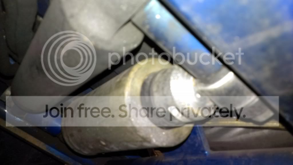

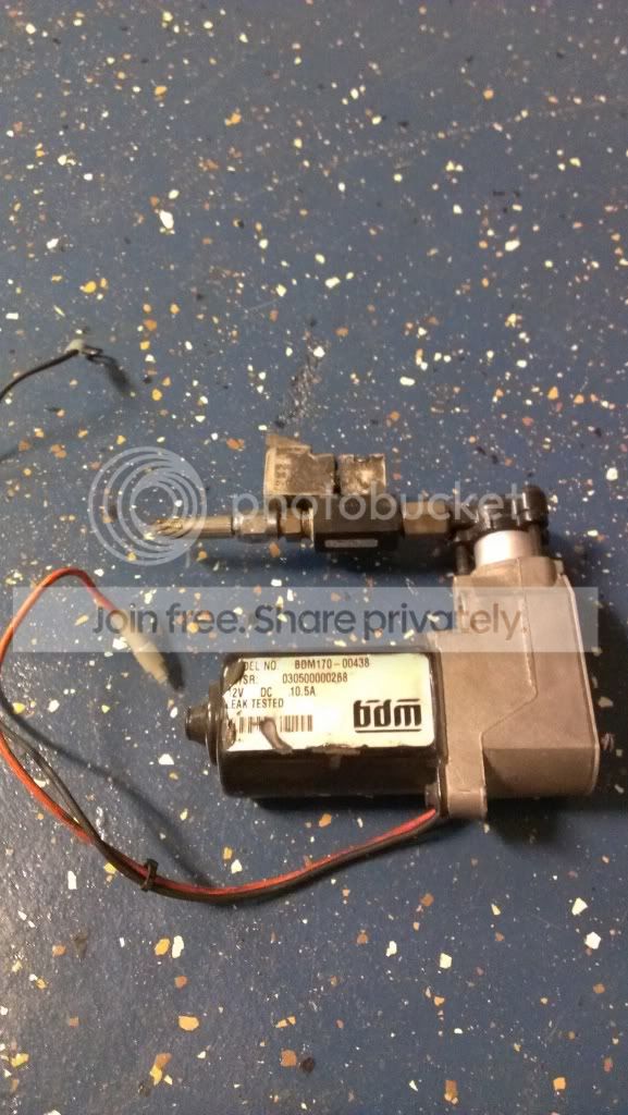

I've been so busy since I picked up the Bulldog that I forgot about some of the extra parts that came with it. One is an air suspension compressor.
Not sure if it even works, but it made me wonder if I had an air shock already on the bike. What does this look like??? Thanks!
hayseed
guessing that silver one is your air shock if its optioned on your bike,, it should have a threaded hole in the back of it for an air fitting that would connect to your compressor.....

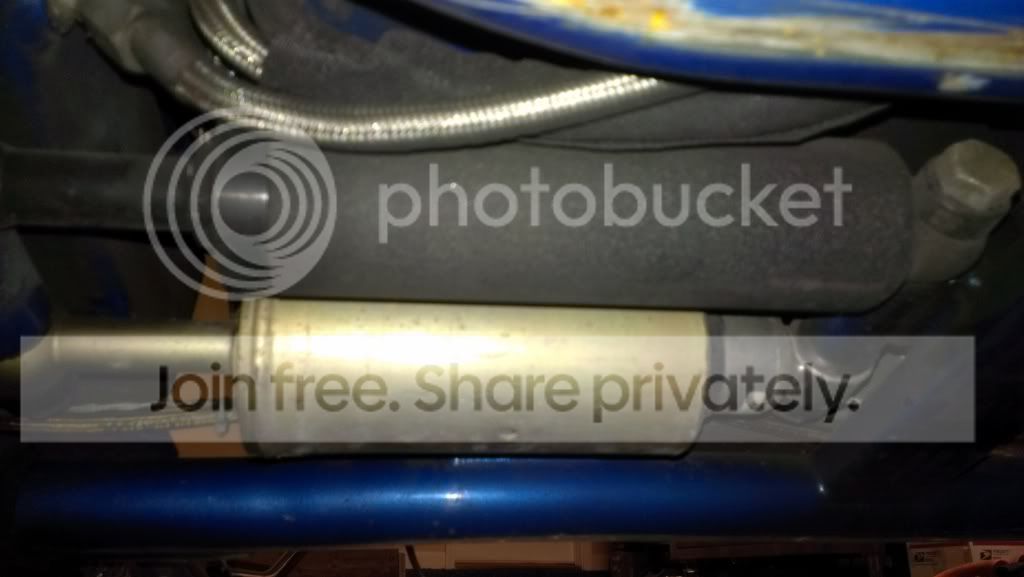

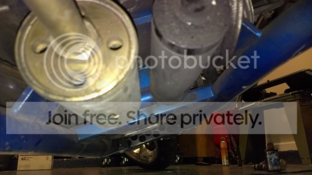

Looking at the shocks. You either run both air or both Manuel. Looks like 2 different brands of manuels
Five Five
Looking at the pictures I would say that you dont have the air shock .... let me know if you plan on selling the compressor unit
liferider
Looking forward to retirement
The more I study these pictures. The more I question, who in the hell would mount 2 different brand shocks working 2 different ways? One collapses from the front and the other from the back! Look closely and you will see it.

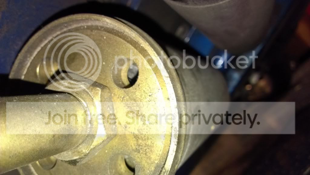

I took a couple more pics, I don't see an air fitting. Is this just a standard damper?
BDM's came with one air shock and one "standard" shock with a bump stop. It's in case of your air ride failing, the fender will not drop so far as to hit the tire
hayseed
hello -- i am curious how that is fastened under the seat ? -- it slides up next to the battery box with nice fit but what locks it in place from moving around ? mine just seemed to be wedged up in there
