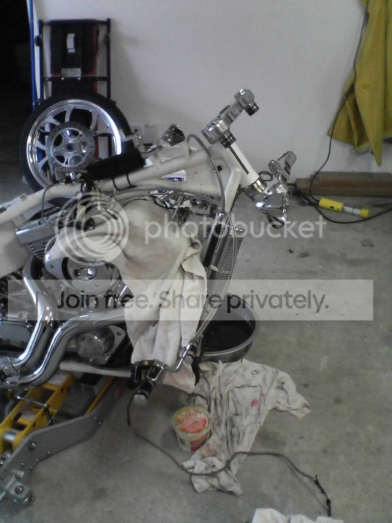

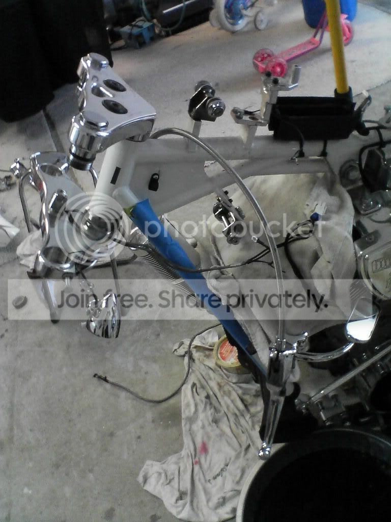

I am gonna try to link a couple of pics that might help you.
In the first pic the bracket towards the triple tree is where you mount the tanks with the rubber grommets
The second bracket is where the indicator goes but you need to put your console on.
Then comes the EHC whic is the black thin then the final screw on the bottom of the console. The last bracket is where your bottom of the tank comes together and there is a tube there. Hope this help you.
