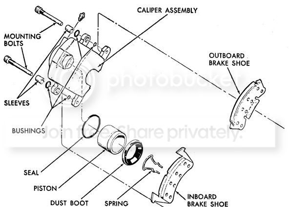

Changing your Motorcycle Brake Pads
You should check your owner's manual for specs on at what point brake pads should be changed (this is typically somewhere between 1-3mm.) Many brake pads will have vertical grooves in them to act as wear indicators that will show you when they need to be changed, Change out your brakes when one pad reaches the indicator even if the other isn't quite there yet. (Note: on some bikes you can slide the pad out to inspect it with the caliper still mounted. Check your owner's manual; if this is the case on your bike you can save yourself a lot of time.)
Locate the caliper that is attached to the rotor on your wheel. Before detaching the caliper, if there is a bolt holding the pads in place loosen it but don't remove it completely. Once it's loose, unscrew the bolts that are holding the caliper in place on the rotor and carefully slide it free. (Because the calipers are heavy, you don't want them to just dangle because they can easily scratch your rim; it's a good idea to tie it up with a zip tie to keep them under control.)
As the pads wear down, the pistons inside the caliper that push the pads onto the disc in order to stop your bike adjust slightly with them. Since there is less padding between the pistons and the disc, the pistons will have been pressed out of the caliper a little more than when the pads were first installed. Because of this, you'll need to push the pistons back into the caliper as much as possible in order to give the new pads enough room.
An easy way to do this is to insert a flathead screwdriver in between the pads before you remove them from the caliper and gently wiggle it so that the pads get pushed back further into the caliper and the pistons reset. Another way to do this is by using a C-clamp to push them back into place. You definitely want to avoid hitting the brake lever at all during this entire procedure as this will pop them back out!
Once the caliper is free from the disc and your pistons are pushed back, remove the pin that is holding the pads in place completely. Some of these pins will be held in place by tiny copper pins. If yours is, remove these pins with needle nose pliers first. Once the pin is out, there may be a retainer spring plate laying on top of the pads which will come right out and then allow you to slide out the brake pads. Some bikes will also have insulators or spacers that will go behind the brake pads in order to make the brakes quieter and reduce vibrations, so take note of them as well.
Now you can put the new brake pads into place, put the spring plate (if your bike had one in the first place) back over them and insert the pin back into the caliper. If you removed tiny copper pins, be sure to put them back in place as well. You may find it to be easier to apply a tad bit of grease to the pin before screwing it back in. Now that the caliper is all put back together, slide it back onto the rotor.
If it doesn't seem to fit back on the rotor, this is probably because you didn't push the pistons back far enough and you may have to remove the new pads in order to push the pistons far enough back into the caliper to allow enough room between the new pads for the rotor. After you get the caliper back in place, add some blue Loctite to the bolts that hold the caliper in place and reattach them to the rotor. Check your service manual as it may recommend tightening the bolts to a specific torque.

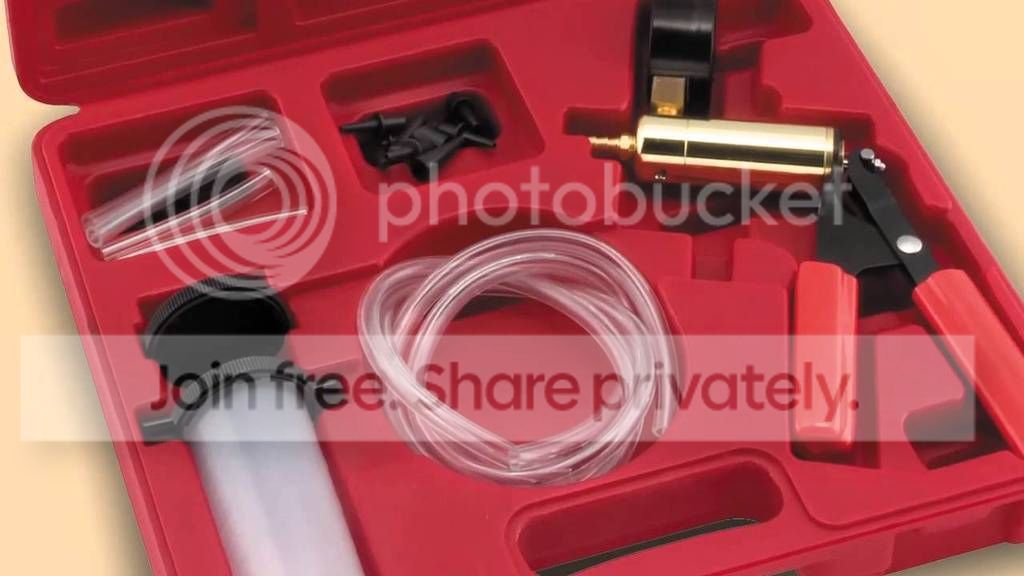

Brake Bleeding Vacuum Kit
The third type of tool that will make bleeding your brakes a piece of pie is a vacuum bleeder kit like this BikeMaster Vacuum Brake Bleeding Kit. Kits like this will come with a rubber tube that will attach to a catch can and then to a vacuum chamber and a hand powered pump. The tube will attach to the bleeder nipple as always and then you will use the pump to build pressure that will suck the brake fluid out of the system and down the hose. Once you open the bleeder screw, you'll notice that the fluid will begin to come out of the caliper without having to hold down the brake lever. You will have to still make a trip up to your handlebars every few moments to check the lever of fluid in the reservoir because you still don't want it to run dry.
After the fluid has be let out for a few moments, close the bleeder screw, remove the tube and do the same thing to the caliper on the other side (if your bike has two calipers on the front wheel). Continue to repeat this process until you see that the fluid is clear and contains no bubbles. Then you can top off the brake fluid and replace the reservoir diaphragm and cover.
