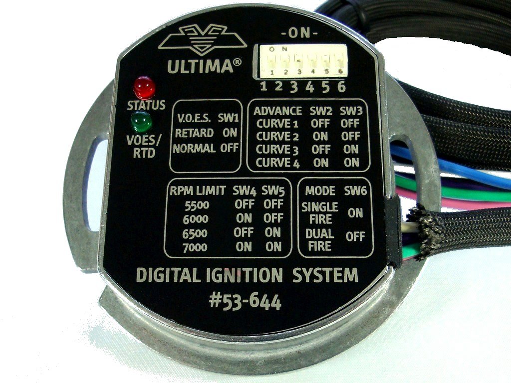

I can't seem to locate my ignition module?? I am not the original owner of the bike, and I have been correcting half ass work since I"ve owned it. Got her running good, but just cant seem to find where the ignition module has been moved to??
I believe it should be mounter under the seat, on the rear fender???
Pic included - its not there--------

The original one was mounted under the seat. It appears that your's has been replaced with a integrated unit. Take the cam cover (2 little screws) off and look in there:

Yes, the new ones are typically single fire (but depends on unit and coil as it is configurable). You can adjust rev limiter and advance curves.
