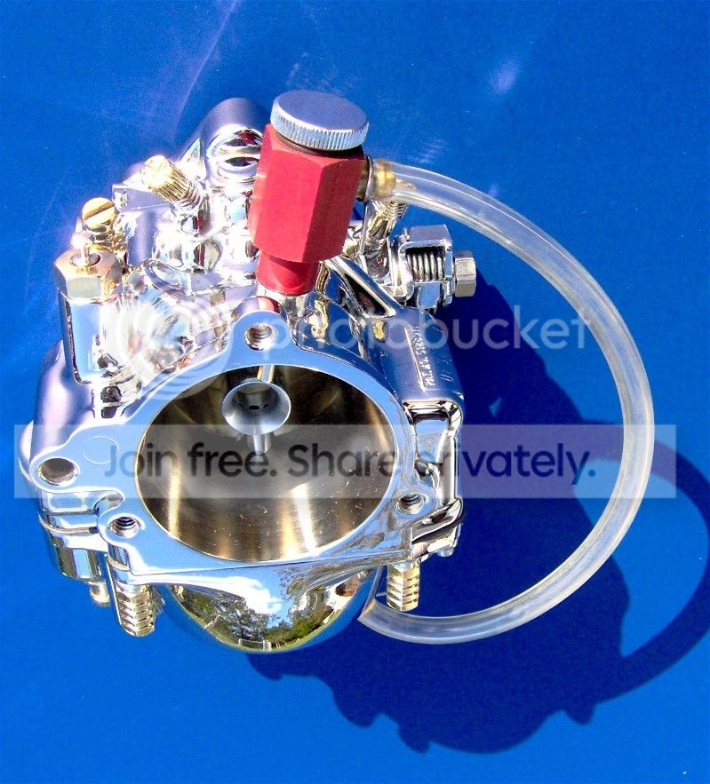

Welcome to the pound Mark....THE source of nfo on your Dog. Now to be clear, you bought a USED bike. No telling how she's been treated. Take a look at your carb. On top there should be two rubber caps. REPLACE THEM. If they have a bit of rot and leak.....bike runs like crap. Also check your tank for FOD and make sure your gas cap is venting properly. Finally, google the s&s carb video and check your carb settings. Keep us in the loop and we'll work to keep your Dog barking.
