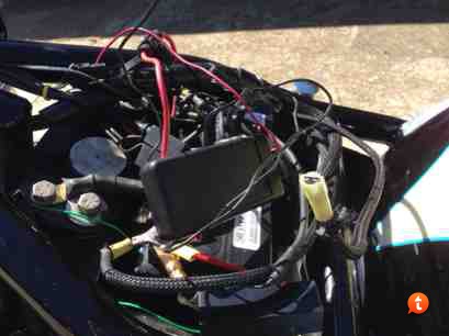

Traced from vr. No circuit breaker in sight. Did find one unconnected wire behind battery that looks like it connects to a spade connector. I am wondering if someone has rewired with one of the kits I read about on
Here. Does this harness look stock? See the one wire that isn't connected. More tracing I guess
here
Ride Safe,
JustDennis
JustDennis
Btw the black box pulled up is a led controller the previous owner installed
Ride Safe,
JustDennis

I think I see the 40 amp fuse box in there... that's is the upgrade they did from the CB.
See here my pics: http://www.bigdogbiker.com/forums/general/53064-what-what-does.html
That fuse close to the oil tank cap in on the battery tender pigtail. I am reading thru the manual and will go thru the electrical drawings and begin tracing wires. Will start testing everything this afternoon. Just bugs me that the wire on the right of the picture toward the rear of the bike isn't connected.
