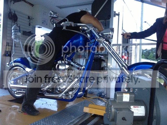

Had the "Old" 07 chopper put up on the dyno In Myrtle Beach at Suck Bang Blow 4 corners just to take a peak at the A/F ,and was curious about the HP of course, Running stock breather with a K/N filter, "homemade washer baffles" on a set of supertrap drags, other then that stock, been running that combo now for 3 years The A/F was pretty close with a possible change to the intermediate? think I'm running a 33/32 have to look but was just a tad rich Numbers were 106.25 Hp and 114.68 TQ from what I have read here this is pretty typical ? The Dyno operator /owner Horst Power Performance out of Oviedo FL was a very honest and straight shooter , I would recommend him!:2thumbs: It seems seat of the pants to be a strong running bike ..." developed a bit of decel pop on the way down , not real bad and it comes and goes but while on the dyno it barked a few times pretty good and spit some fire ! :lol: 585cam change one day maybe but its runs so good just the way it is!!! We rode into the bar a few times and woke up the place just to let them know the dog was back in town ...was a good time !
Oh yea the original battery still kicking it with somewhere around 15000 miles and with the org EHC, and we got drenched on the way back real good!!! for about 100 150 miles oil pressure light and neutral light on the dash was illuminated dim while riding in the deluge but quickly went back to normal .. I must have a good one ?
