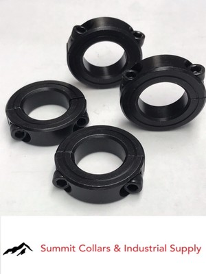

I ordered a few of these to secure it from sliding down and thus, having it stolen or lost. the tape would still allow it to get taken.
I'll give an update when they arrive. cannot understand why the newer ones do not have the 4 set screws to secure it to the bar.

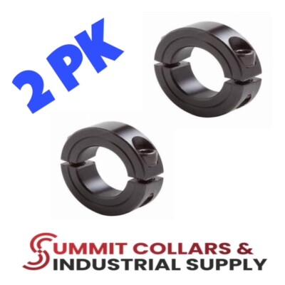

gotcha. took a look at the taper and I purchased a set of these
to keep the pad from sliding down from vibration or the possibility of theft. they blend and hopefully will look like they belong there. thanks for your insight.
