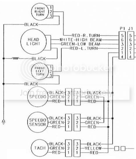

im trying to put my new to me head light on off of an 06 chopper and the wires are different colors on by bike compared to the pigtail on the light. need to know what needs to go to what. the pigtail is black, yellow and white. and i believe my bike is green, black and red. ill double check and correct if i need too thanks

On the '03 it should be:
white (pin 6 of P-1) - high beam
green (pin 3 of P-1) - low beam (yellow on the pigtail for '04 and later)
black to ground
Does that help? :D

yes that does help but, there are four wires on my bike
white
green
black
and red?
any ideas on the red wire
