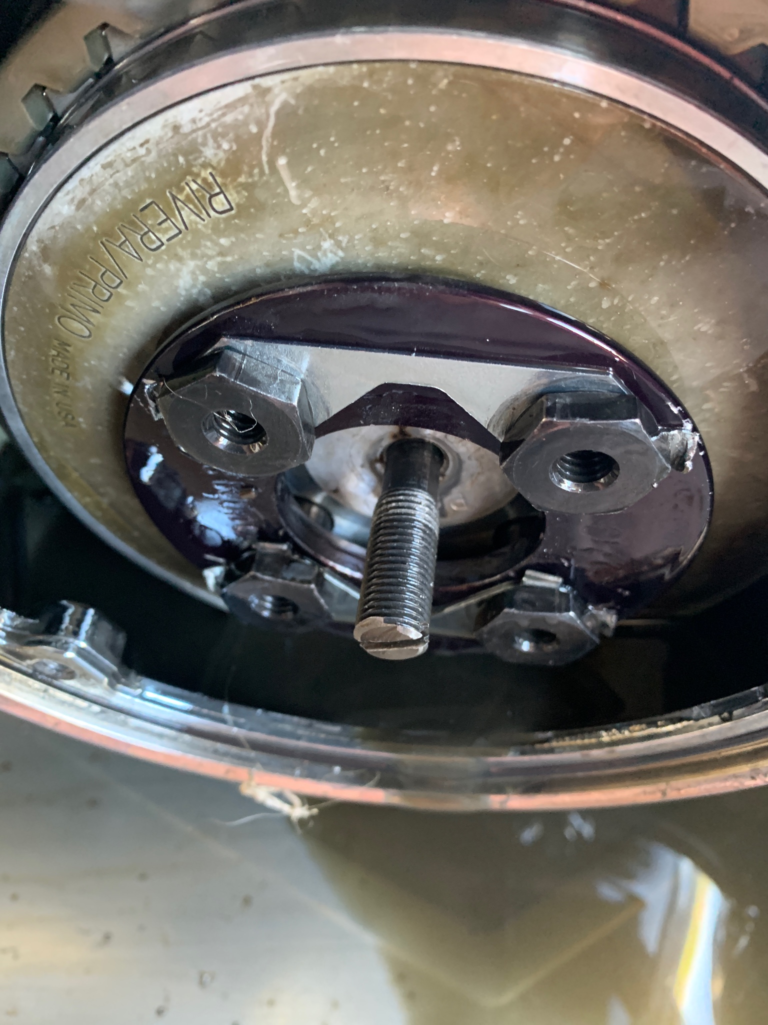

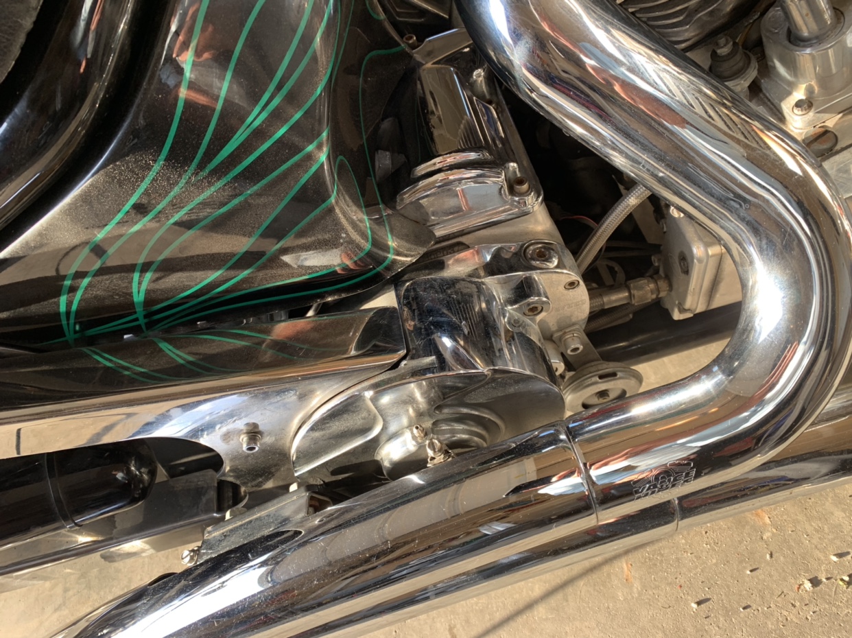

Last week I put a new clutch pack in my Ultima open primary. Up to this point it was running fine. I run an HHI hydraulic clutch with a pro-one actuator. Since I put in the new clutch pack, I cannot get the clutch adjusted. It creeps when stopped in gear with the clutch in, but slips when cruising down the highway in 6th gear. I've tried adjusting it every which way, bled the lines, etc. For some stupid reason I didn't order new springs, but I will this week. The old clutch was working fine, it was just beat and I knew it needed replacing soon. Any ideas?
