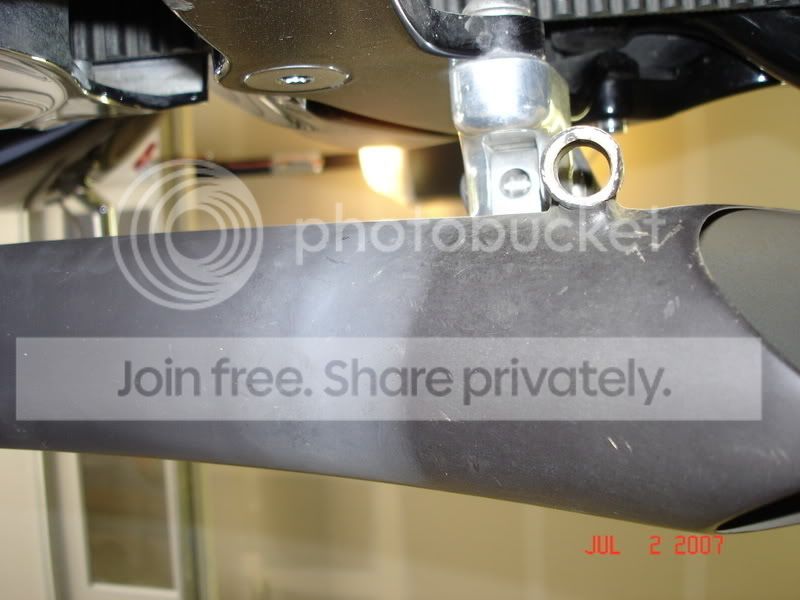

I ran the Ghetto Blaster on my bike and it has an offset bracket that I had to make cause the stock one didn't fit. I believe there is enough room for them to fit on a 300 but you will have to make a new bracket.
Here is a picture of mine with the spacing from the swingarm. Plenty of room.
Have fun,
Ray
