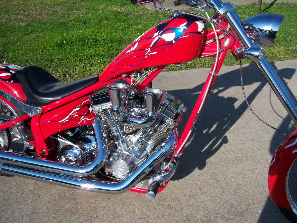

Hey Guys, Dad(T.Byrd) is running a wimmer dual. We worked on it yesterday and couldn't get it to run with the Triple X. We took everything off to the carb, then ran it, ran fine. But when we put the dual throat back on it wasn't getting enough air. So he was thinking of going back to a stock intake(S&S). I know alot of people here have already changed theirs to something else. So does anyone here still have theirs and would be willing to sell?

Thanks guys:cheers: We turned the stacks up and ran fine:confused: It was getting to much air I think? Will post some pics of it later. Thanks again for the support and help Guys:2thumbs: I Love This Site:choppersmiley:
Byrddogg

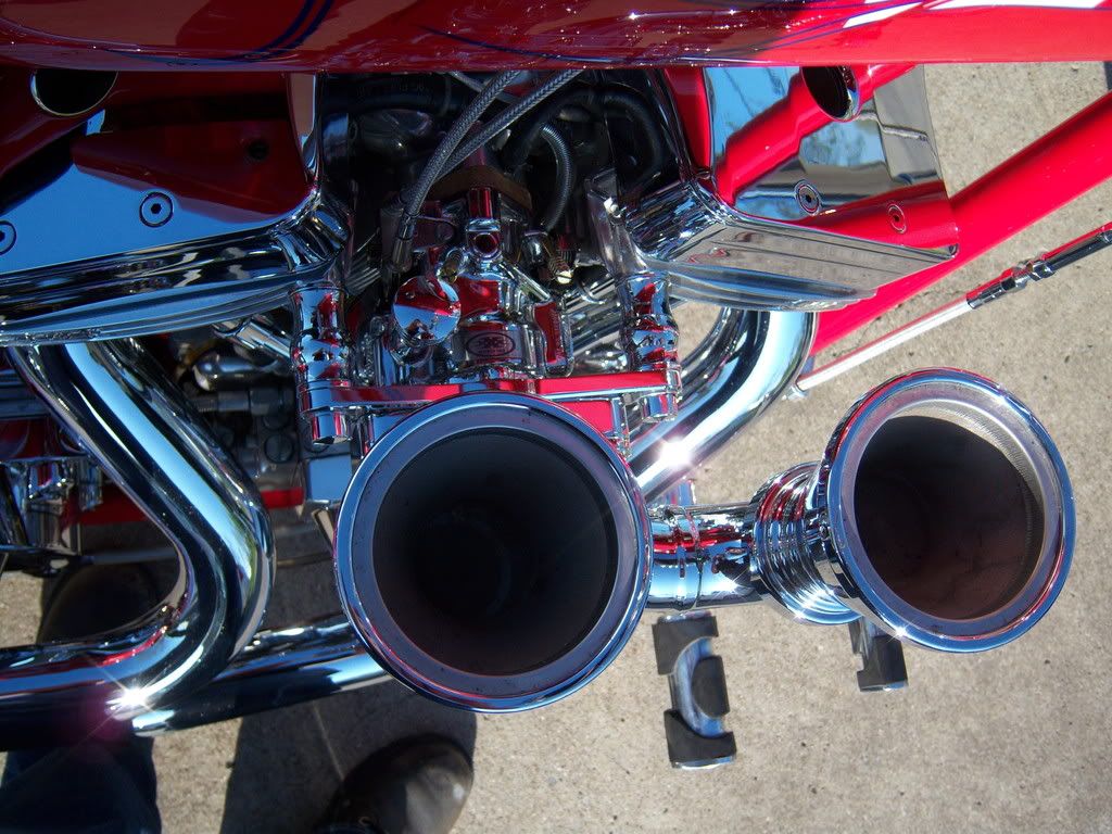

We rode it like this yesterday and it still had a dead spot in it at 65-70. When we got home dad took out the allen screw from the bottom of the carb(Triple X guy said to) and it ran fine. NEW LOOK:eek:

They look so good I would get some advice from some here before going back to stock. :2thumbs:
on a side note, They look like there is just a screen mesh and no filter?

i looked at them and were interested yet i am not willin to put anything on my shit unless it has a proper air filter,they surely look pretty kool though and i know you can get a stack for it that has filtration.....

I got every thing lined out and running good.With a setup that does not
have a filter system s&s says that you havet to run with breather screw
out did so and running fine. This system is a Wimmer Dual Stack System
runs 1k.
