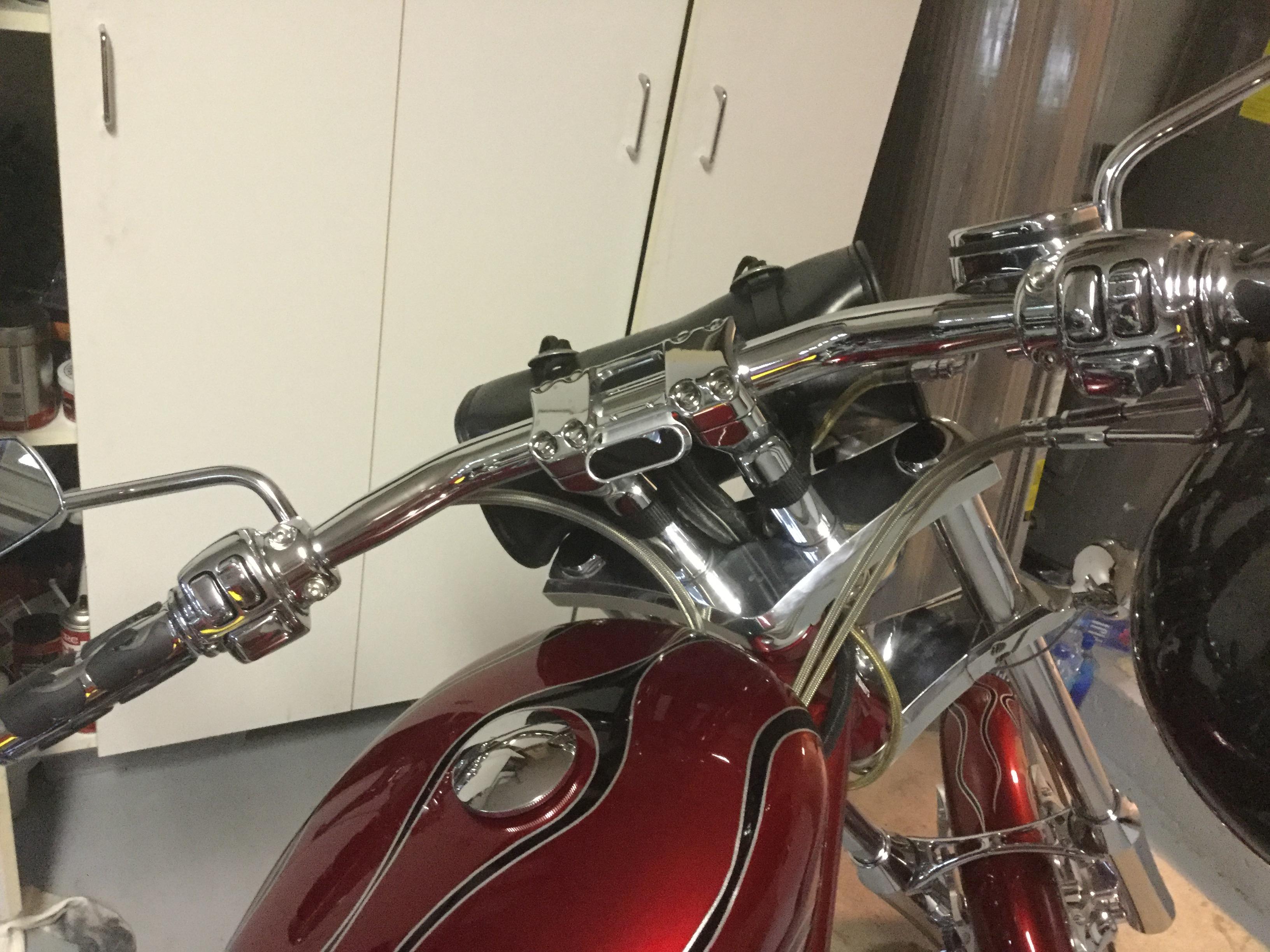

Can I see a couple of pictures of your motogadget I almost went that route but bought the plug and play from axel instead. I was told 3 times the m-unit wouldn’t work because the switches on bars required to low of amps???? Yours seems to be working fine I have two bikes one with axels Unit and one stock. Please take set one pix and details. Thanks

I was talking about the speedo, not m-unit. to my understanding that is pretty good system though.
