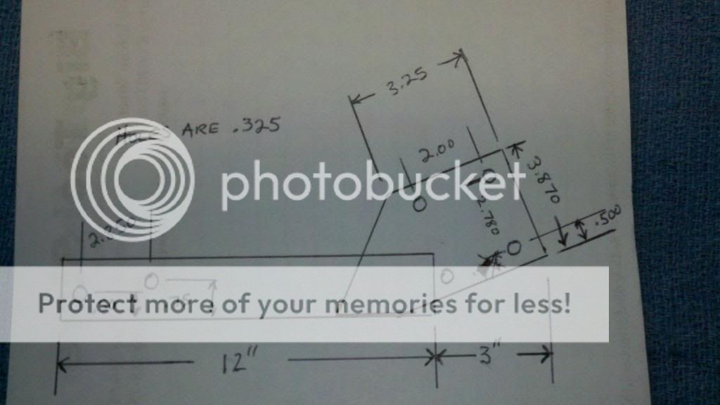

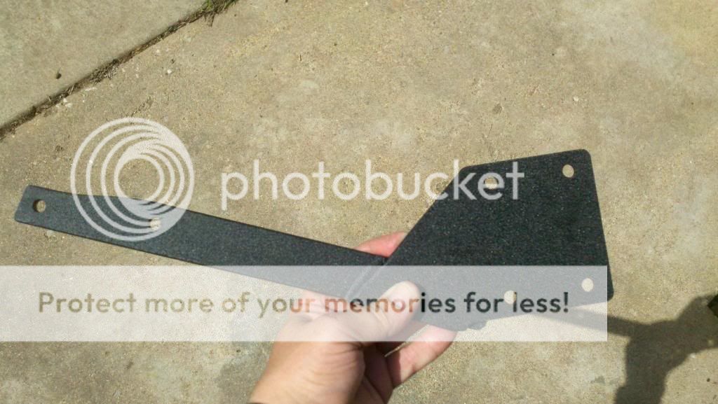

I am wanting to install these pipes on my 2004 Pit Bull.Will I have to make my own bracket to attach pipes to frame?thanks for info
HMAN
I just like my Freedom
1/8"-1/4" should work. Whichever you can find easier. Its not really holding weight, more of a stabilizer so the pipes don't rattle.
Jwooky
careful...not much weight, but an incredible amount of vibration.
Mine have broken in the corners twice and I had to reweld. The second time I added a large filet in the corners. I think the OE V&H is 3/16
HMAN
Send pauldeepsea a PM, an ask him to measure the thickness. I believe I sent him the bracket with the pipes?
