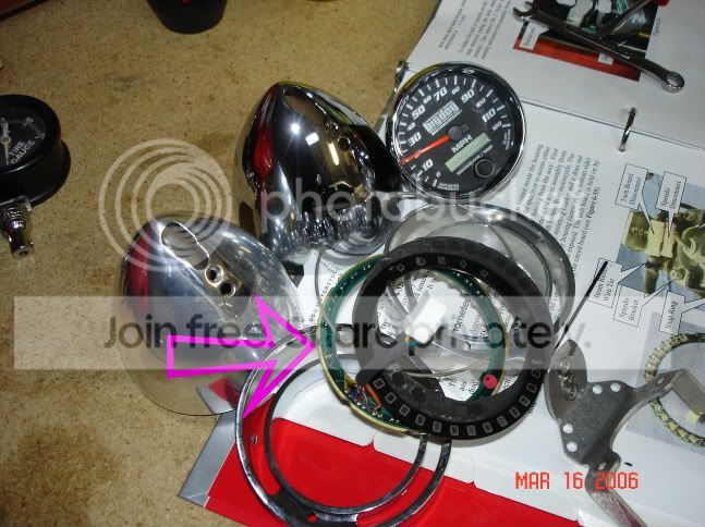

But if it turns out to be the indicator then you will need to order a new tach board only. It's the green ring in the picture but I'm sure you have a loose wire somewhere.
