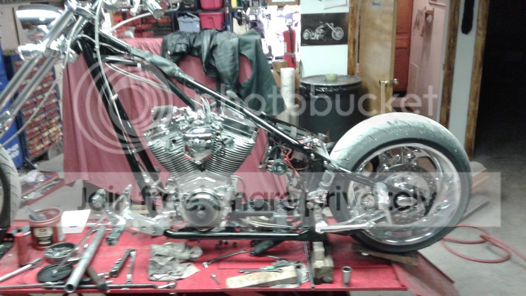

Sniper stopped by yesterday and said he had a whining noise when he pulled the clutch in. I took it for a ride and told him it sounded more like a transmission bearing. Pulled it apart this afternoon, clutch is good. As a mater of fact, you could still read the brand name on the face of the disc. Hub nut was tight, but when I pulled it off, you can see where it was rubbing the inside of the inner primary.
Pulled the trans and took the cover off the side, full of metal shavings. Sorry no picture. Told him there was no reason to go any further, we'll just send if off to Andrew and let him rebuild it.
I guess it couldn't handle 145 hp. While we have it apart, I guess we'll freshen his up to.
