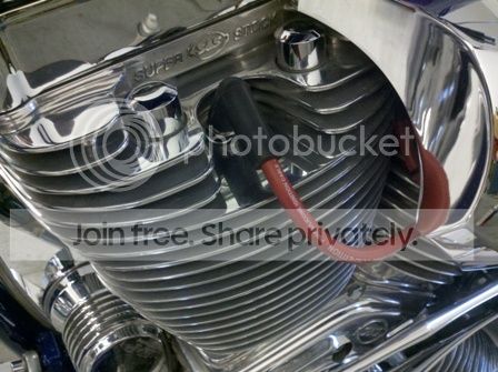

Put new OEM S&S high output coil on it ….still same problem…. EHC would drop out after one revolution….dammit….….:bang::bang::bang::bang:
With trial and error…found that unhooking the front cylinder primary wire to the coil would let it turn over normally….what the hell….???
Put new spark plugs in it….still same problem…would only turn over one revolution and the EHC would drop out, stopping the starting sequence…..
Just out of curiosity I put a suppressor (ferrite bead) on the coil primary wiring before it feeds back into the VFI……it would then turn over normally….interesting …problem seemed to be fixed…
I found the problem, or at least corrected the problem….any guesses to what really fixed it??? (Hint....the ferrite bead on the coil primary wiring was really just covering up the problem)
