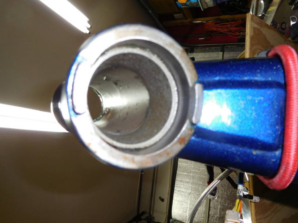

With almost 20k on the bike figured it was time to tear down and replace the neck bearings and races anyways. Bought the race removal tool and the race press (worth every penny) makes this job a breeze.
Well here is what I found. I needed a breaker bar to loosen the stem nut on the bottom and I assume the previous owner had issues but the shop he used just tightened the hell out of the neck to try and correct it.
I assumed the first race was installed incorrectly but unfortunately not.
Now these are the non removable neck cups, so I cant just press out the cup and press in a new one. My 2004 has removable cups and appears late 2007 K9 - 08 they went back to removable. I was the lucky winner of the non removable neck cups...go figure.
Gave Shannon a call as this is in his wheel house, his first assumption like mine was it can't be seated all the way. Well I thought it was and that tolerance is quite wide with these types of bearings but went ahead and made all the measurements .061"-.062" depth all around, so well within normal acceptable tolerances. So I knew for sure it was seating correctly.
Next up was measuring the diameter of the neck cup in the frame itself, Shannon assumption here is when they welded the neck they shrunk the neck cup. He said "I bet the back side of the frame you need to take a material off". Well I went and measured it...looks to be 1.956" from about 1-8 and 1.972" at 3 - 9. See below diagram, Now I need to take a little material off the back side roughly .010"-.012" of material of the back side. The Race is 1.980" and considering I don't have any play in the bearing with the 1.972" measurement from 3-9 I will suspect that I need somewhere around that on the backside for the race to fit correctly.

This wasn't fun took me about 2.5 hrs as I didn't want to take too much off so I just kept taking a little bit off and measuring it and reinstalling the race. I probably removed and re-installed the race 10-12x, with the right tools its not a big deal takes a couple seconds.
I took off most of the high spots and got to the point where I have just a bit of play left but the race is continually to become easier and easier to press in so I'm trying to ear on the side of caution and considering the play is probably reduced by +90% I think I will be in better shape. At the end of the day if I still am experiencing issues I can tear it down again and try again. I would rather do that then figure out how to cut the cup off the neck or end up having to tack weld the race in place (which I thought about).
