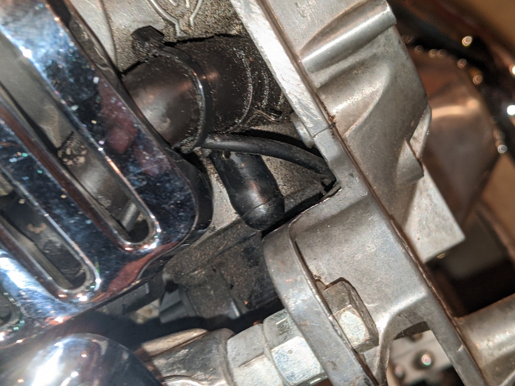

Squirting sound from throttle body.

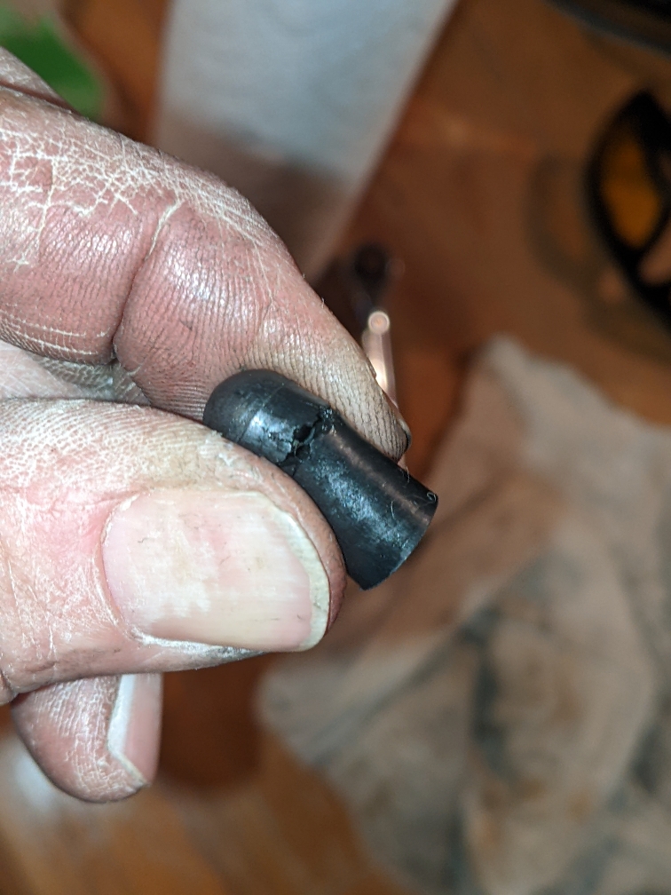

The little black silicon caps strike again. Should not cause a gasoline leak but a vacuum leak that will result in very poor performance. Cheap n easy to find @ auto parts store. Replace and keep searching for your gasoline leak.
