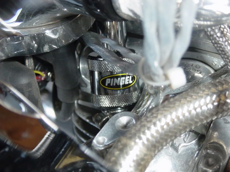

You mentioned cleaning the fuel filter... these gravity fed fuel systems are not suppose to have a fuel filter. It takes pressure or force to push the fuel through the filter, the fuel in tank creates pressure in the line, more fuel in the tank more weight forcing fuel into the bowl; if there is not enough fuel in the tank to create that force the fuel pressure thought the filter may not be enough to keep up with the demands of the carb. Pops through the carb is a symptom of a lean condition as well.

I also agree with Exotic about the fuel filter, dump it! Overall it'll give you more grief than benefit...
You can run a Pingle fuel filter with NO PROBLEMS!!!
