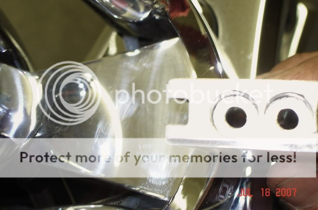

Here is a pic of the new mount. Old one on top of the wider new one.
