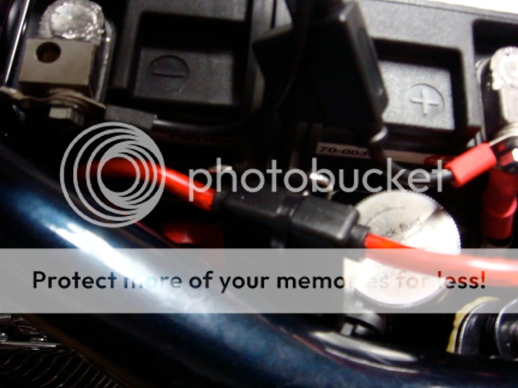

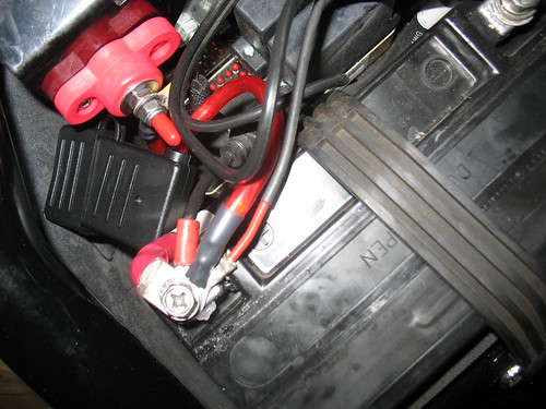

sun... he did the VR recall... you probably have the red stud terminal down under all the mess. No more CB, just that 40amp maxi fuse. However, now if it pops, you can't just reset it. You need to carry some extra fuses. In the VR recall thread I linked a few auctions... I suggest you go buy a few. Just in case. May be able to get them from car stereo store as well.
