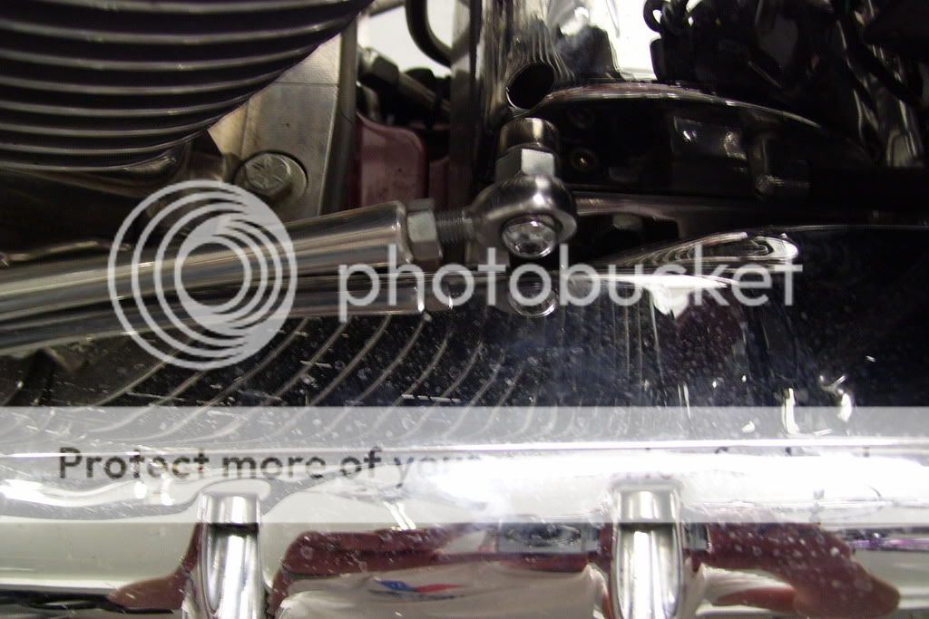

I don't have a spacer on either side but looking at it now it's cockeyed! :eek:

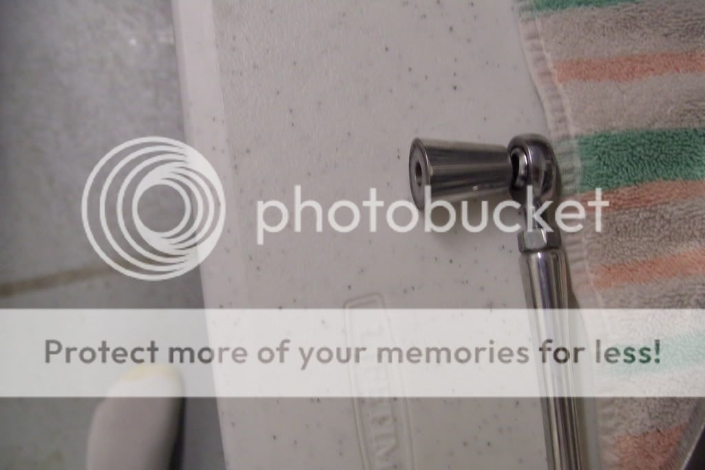

Here is the front one.

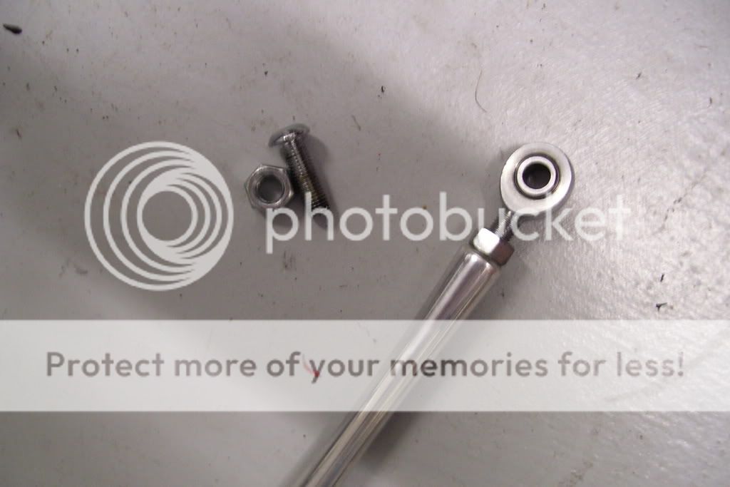

And the rear one.
And the alignment. Kinda dark!

Nope ... just the bolt going through the Heim Joint. Wonder if they used a longer bolt? 5/16-24 x 7/8" is the stock bolt

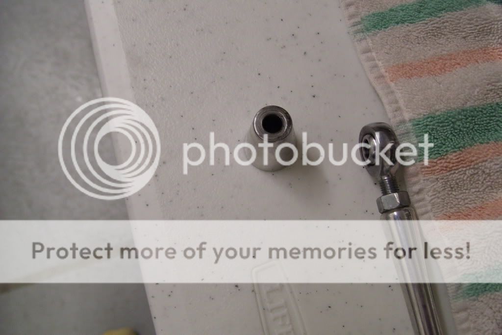

Here is mine I can't show the front control cause I have it removed but here is the front cone spacer
Here is the rear with the nut as a spacer
I will check how it lines up when I put it all back together. May end up keeping the nut spacer as it has worked pretty well so far.
