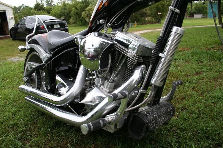

220 miles my house to Daytona down pour all the way up and back. Did this run twice like this with no problems. On one of the runs I was having starter issues not related to the rain though (see my how to post on how to fix the Click, Click.). I get cought in the rain all the time, left the house in the rain to do the Memorial Day ride this year..:whoop:
One of the Daytona run's.
