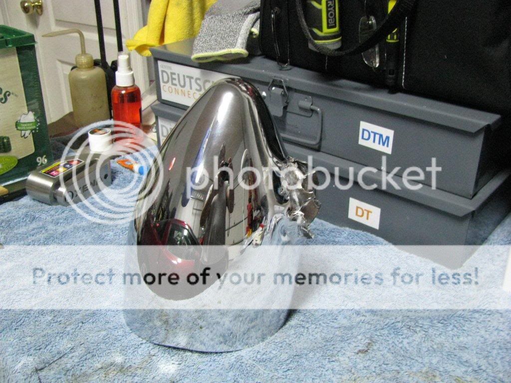

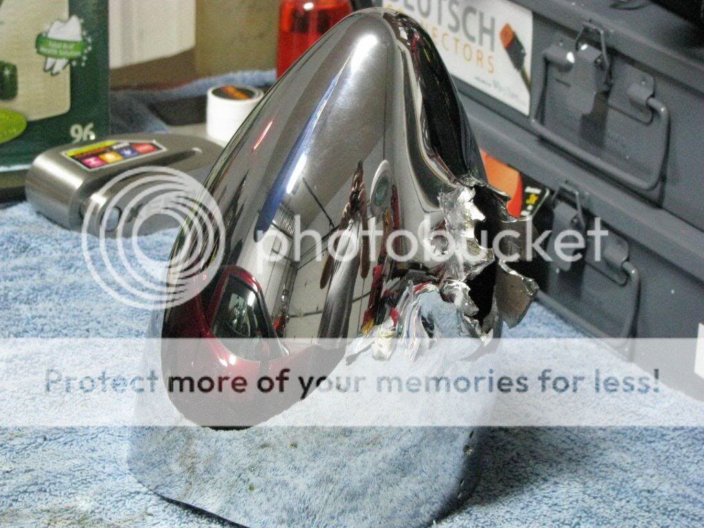

Are you going to replace them? If not, anything can be removed! Just cut off the wires and put a socket on there to remove them. Just be advised, this advice is coming from a person who started to remove the BD head light and when the chrome started separating from the bottom mount, I just grabbed it with both hands and ripped it off. Then I put an easy to mount and remove Adjure Headlight.
A picture is worth a thousand words. There was no way I was going to deal with this hard to remove head light and fix the chrome which came loose when tapping the retainer ring off with no success.

Holy Shit Nuke, Looks like you Nuked the fuck out of that headlight. Nothing like removing the wire harness with ease. :lol: :lol: :roll: :roll:

That's about how my stock bucket looked like after it cracked...:D
Nukeranger
Nukeranger
Yeah, once the chrome started separating from the bucket, I used the quick removal instruction.
I wonder if I could put it on ebay as low mileage and minor damage! - NOT:roll::roll:
I'll keep it around as an ornament. The headlamp, light bulb and plug are still good. The headlamp is kindof hazy though.
Nuked the crap out of that headlamp bucket I did.:roll::roll::roll:
I should have consulted Sven on the removal. OK, maybe not.:roll::roll:
Carlos :lol:
Finesse gets it every time:2thumbs If it don't move with the first lick, get a bigger hammer:D
