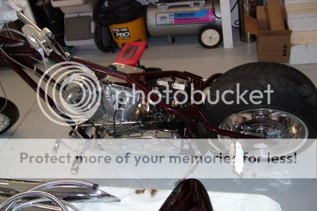

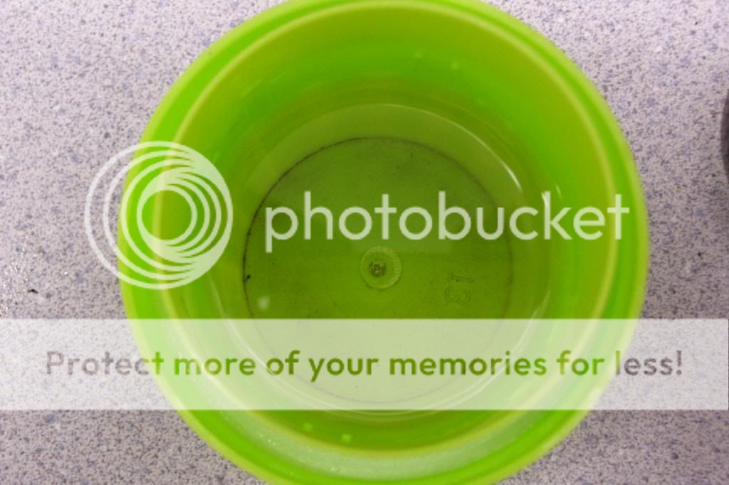

At the suggestion of many I pulled off my tank to do the shrink wrap thing Gas posted. I had the fuel line off anyway to remove the carb see prior post. Found more stuff thats needs to be addressed. My k-9 will be two years old on 4/1/08, keep that in mind when viewing.
Check out the dirt in this cup!

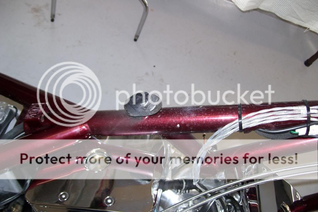

I think my set up is a little different then the choppers. See tank upper bracket below.

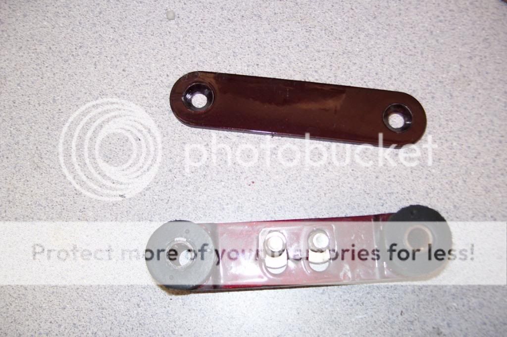

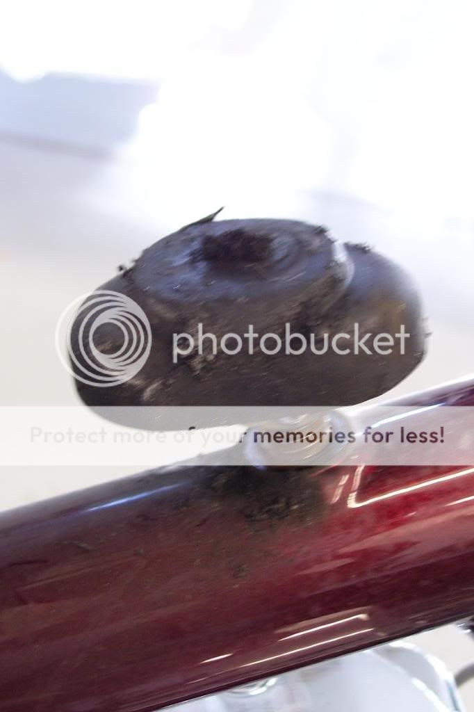

The next pic is of the bottom of the tank where the rubber mount slids into, to hold the bottom (end near the seat). Sorry fuzzy pic.
This rubber mount and the rubber grommets were really soft. The bolt would have pushed through any time. They were really gummy.

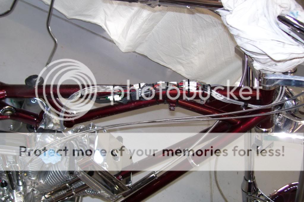

See wiring harness and wear below.

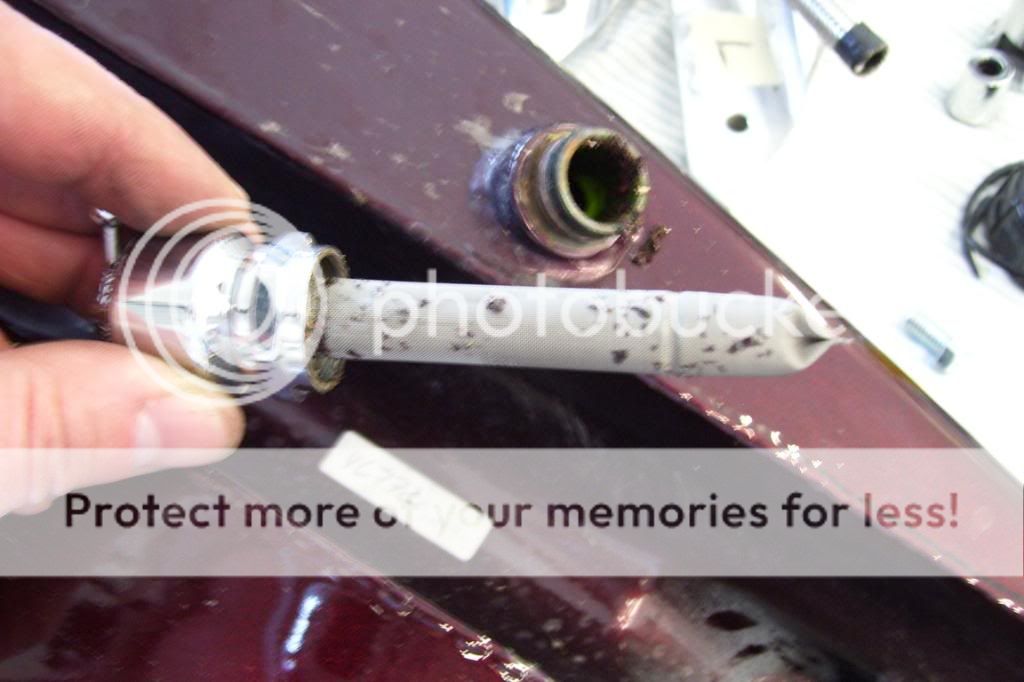

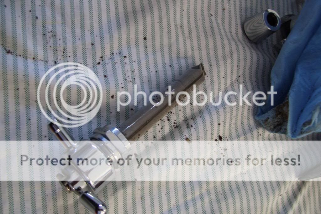

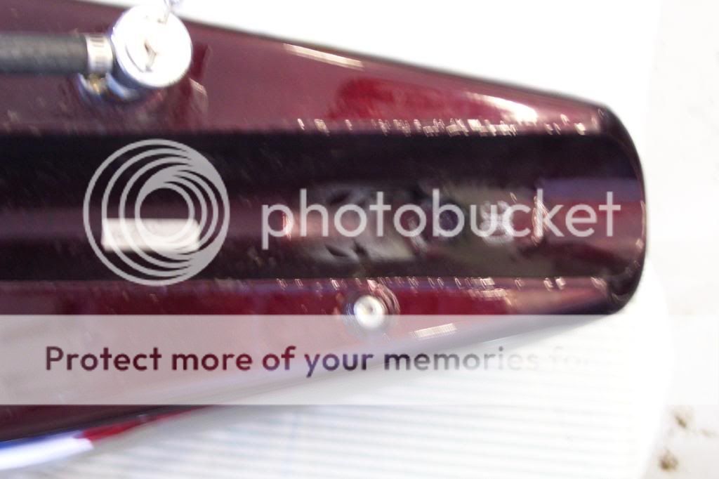

Now on to the fun. I drained the fuel and removed the petcock. Now I know where all the grit in the bowl came from.

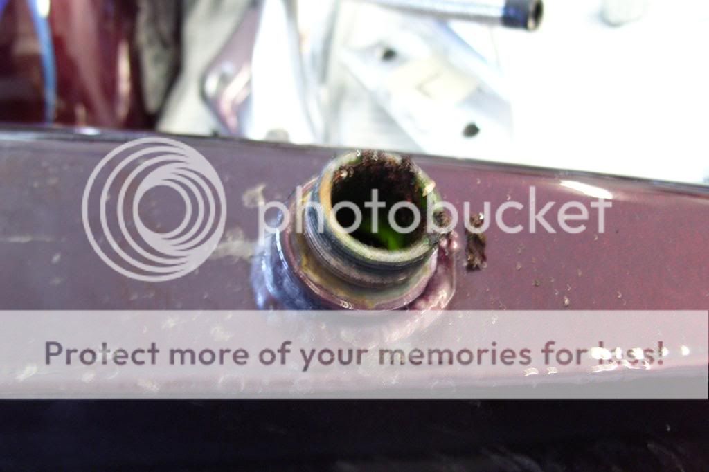

I am surprised it actually ran with all the dirt and rust in the tank. I am in the market for an in-line fuel filter and I would suggest one to everybody. PLease send me links for those of you that have already installed one. I looked in the tank adn I saw the green slime they use to coat the tank, but I could see more grit as well as rust up by the neck. Didnt have time to do a full deep light inspection had to go to church with the family. Also I don't have a photo, but I noticed the aluminum ring that the gas cap screws into ( can't remember the name) is not flat on the tank. One side touches the tank but the other sticks up like an 1/8".

On the tank mount... looks like you need a new rubber thing. That is just a difference in tank mounts.

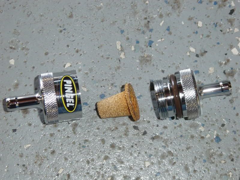

Here's the inside of the pingle...
Its some type of press brass balls or something.
