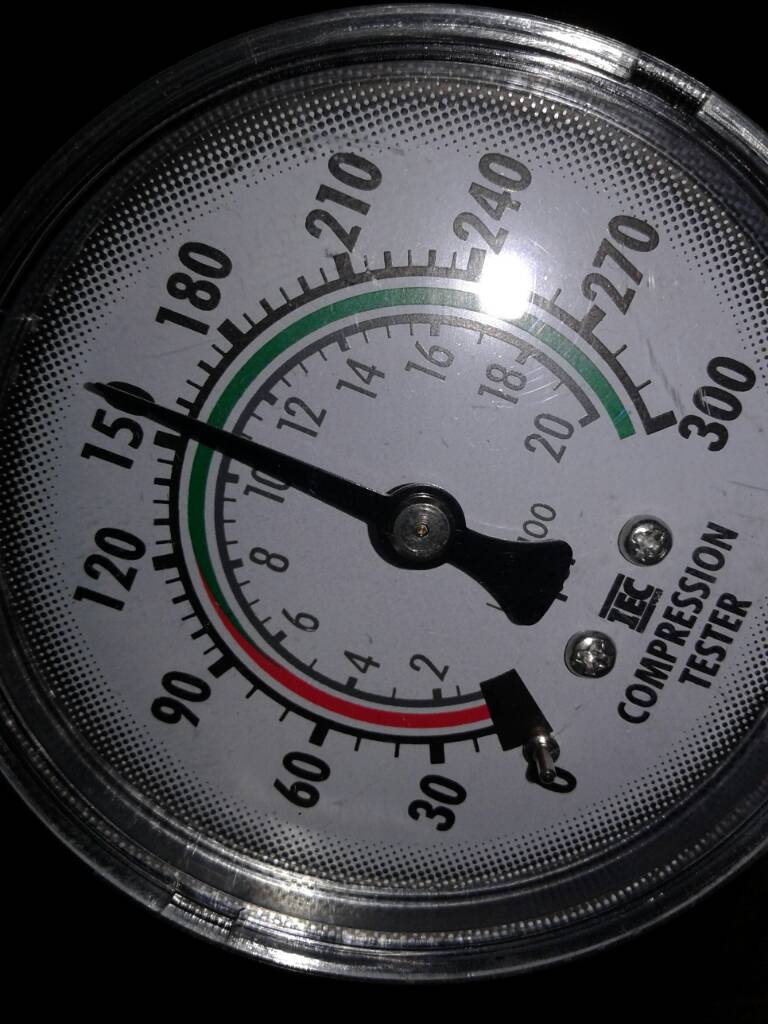

Both cylinders test at 160..so will try break clean..used wd40 but that aint much...put new iridium plugs in..after bigger jets some black smoke ..thinking i need a 32 intermediate

What are you guys seeing for compression...i was 20 # higher if i rolled.over more but books generally say 4 revolutions..

Don't care what the book says. Crank engine, with the throttle wide open, until the gauge stops moving. That's the compression that's in that cylinder. Any other way, you're pissing in the wind.
