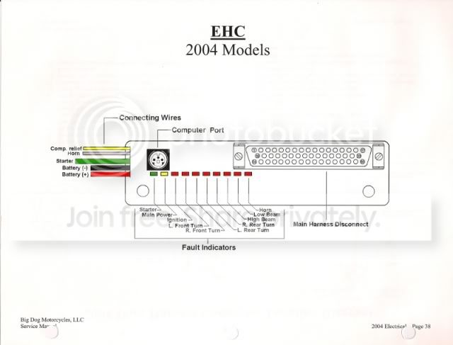

The schematic symbol on the headlight ground wire that you are referring to is "supposed" to be a "Choke Coil".
However, it DID NOT work for BDM on the headlight failure issues!
So if it's there fine, if it's NOT, it's fine too.
fyi: "If" you are having headlight failure issues, first check and see "IF" the headlight H4 plug is melted and/or deformed in shape.
- "IF" so, replace with a "High Temp." rated H4 headlight plug w/6 inches of 14 ga. "SOLID" wire pigtails connected by "individual" heat shrink-ed "Spade" terminals into your existing headlight terminals, via the headlight wiring harness, AFTER the "existing" insulated H4 housing is removed & discarded. (The increase in soild wire size & spade terminals acts as a "heat sink" to draw the excessive heat away from the NEW H4 plug & "terminals". This greatly reduces the risk of headlight failure!)

- But "IF" the headlight H4 plug is NOT melted, nor you've found any headlight wiring harness issues. It may be that the EHC Headlight Circuit has gone bad within the EHC controller. It's a VERY common issue within the '04 EHC controllers. (A little different circuitry within the '04's, than in the '05 & newer EHC controllers. The '04 design was more likely to "permanently" fail due to NO internal "individual circuit surge protection".)
I hope that this helps.
Good Luck!
