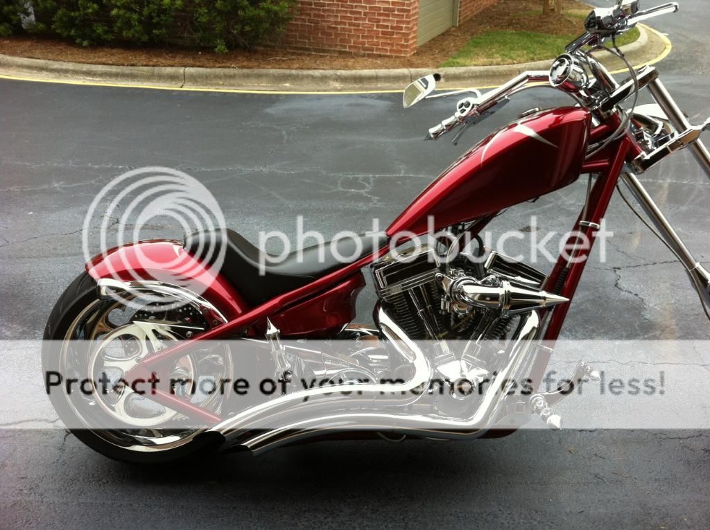

Ok so on my last custom I built I had a set of shot guns on her and when I let off the throttle it had a badass cackle to her. I LOVE that sound and want to get it back. I have the Big Radius V&H set up right now and LOVE the look better then the shot guns but miss the cackle. I know it will never have that sound with the long tubes of the shot guns but if I take out some of the baffle will this in turn give me more of that cackle or just make it to loud and have to much back preasure?

This is my set up! I will check out the Big City Thunder Baffles as well. Wish I had some sound clips to listen to...................
