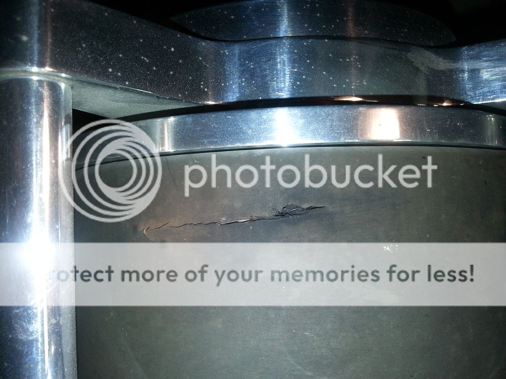

Ok, here's the first picture that wouldn't show up.
The problems you will have is, shoe laces, pant legs, small dogs and children, and this picture of what happens when a rock gets in it.
Spikes05
The Baker open primary only has a 2" Kevlar reinforced belt I ride my bikes very hard and I have only put a few light scratches in them that polished out with no problems. I am running the same belt and I have nearly 8,000 miles on it my chopper has a little over 12,000 so I guess if you choose a open primary other than the one that was built to for our bikes then you might run into some problems. So far the Baker has been problem free.
