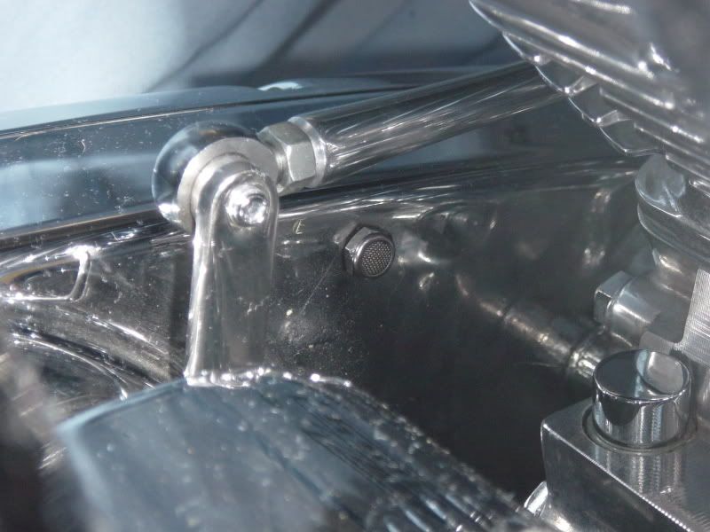

But you'll find that BDM quit using the vents in the cover and put in button vents on the backside of the inner primary between the motor and the tranny. So the "vented" cover is useless!

The button vent I'm talking about is shown here
and you can see the hole just to the right of the center bolt hole above the adjustor in this pic
